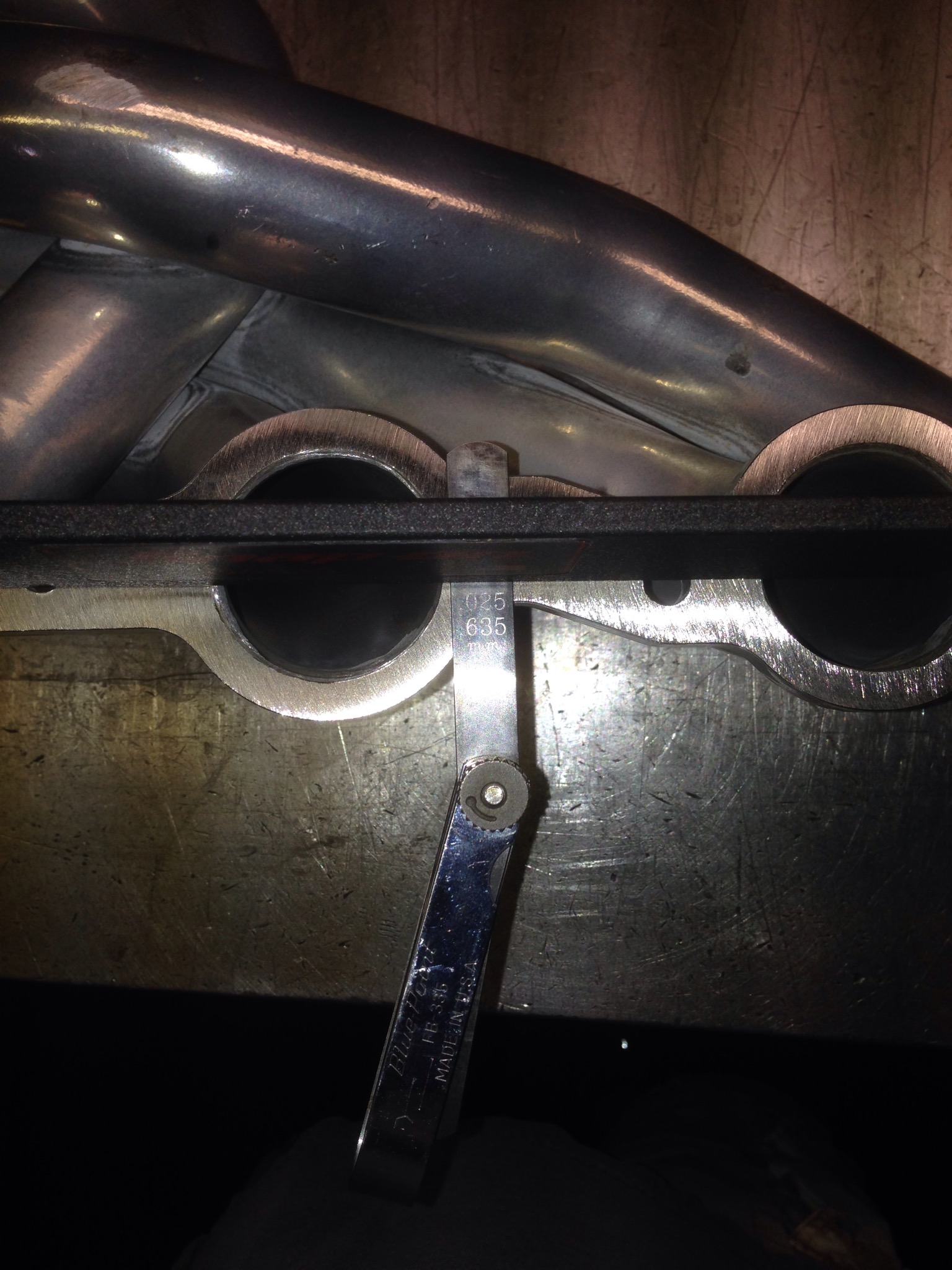

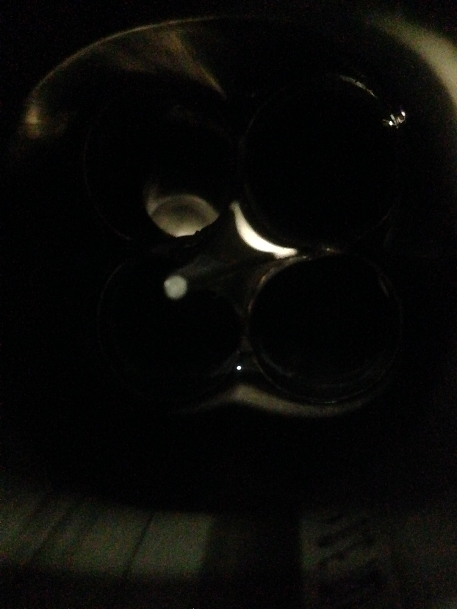

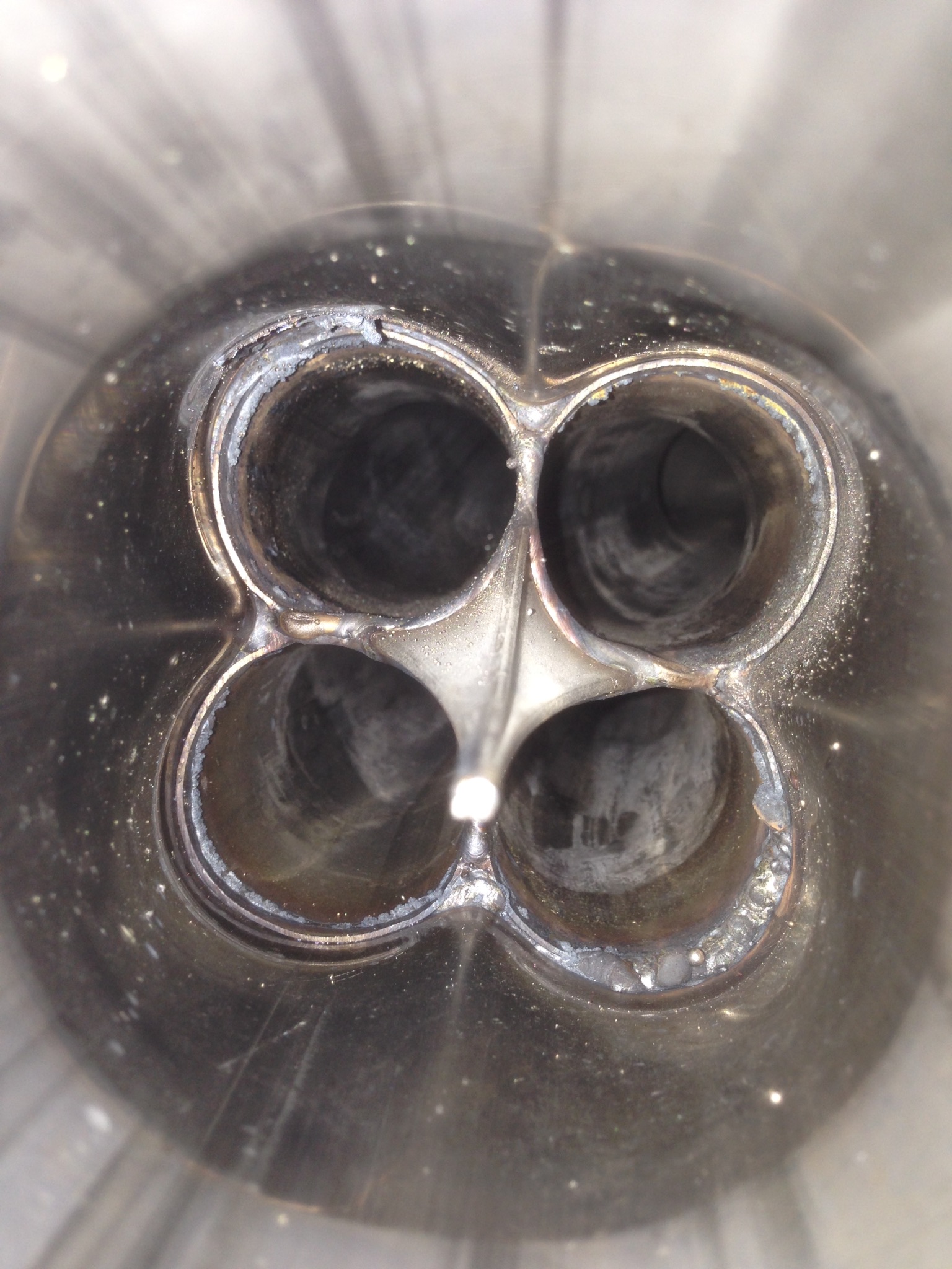

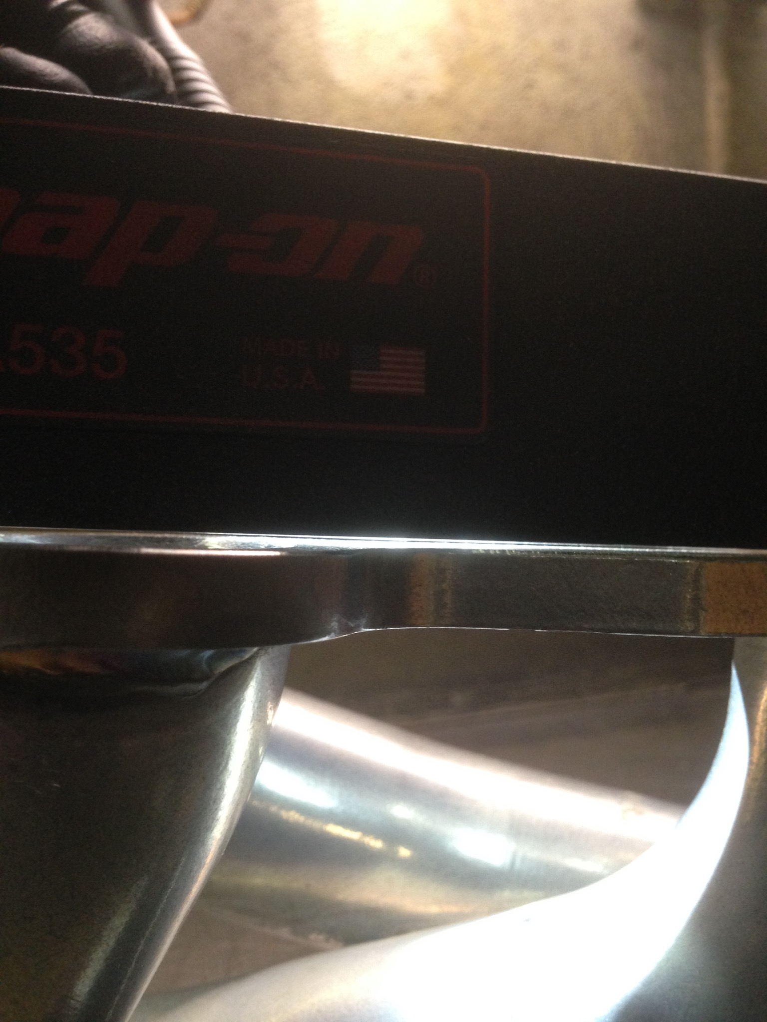

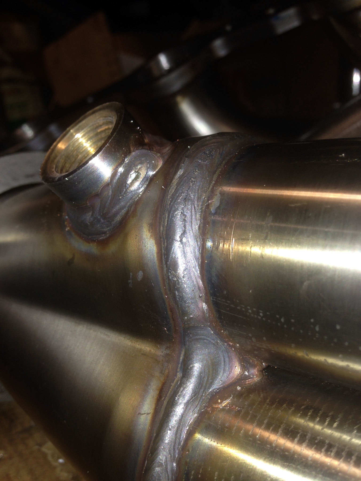

I would like to share my recent high dollar poorly made long tub header ordeal. I bought a set of headers and y-pipe for my Silverado. It took six weeks for the headers to show up. Now the first thing I should have done was put a strait edge on the manifold flange to check if it's flat. I didn't do this but I will from now on, at almost 9,000 miles I had to take headers off cause the pass. side was hitting the frame. I also notice the Percy gasket that came with the headers had started to leak. Sent the headers off to get fixed and the pass. Header flange was wavy and I could measure .025 warp between two ports! I went an measured drivers side and got .023 warp and they never even touched that header. GM spec for the manifold warpage is .010 all the way across. So I told them I wanted a replacement set these are not going to seal very long. They finally sent me another set but they both have pinholes in the welds on the collectors. I would strongly recommend that if you are running kooks headers you may want to get them checked out. I'm never gonna deal with them again.

I'm looking into some different headers now but I'm still dealing with this return crap so I can get my money back. I even drove out to kooks so they could test fit a new set of headers and then they tried to straiten one of the headers with a 6" electric hand grinder! That's how they surface their headers apparently which is impossible to have a true flat surface.

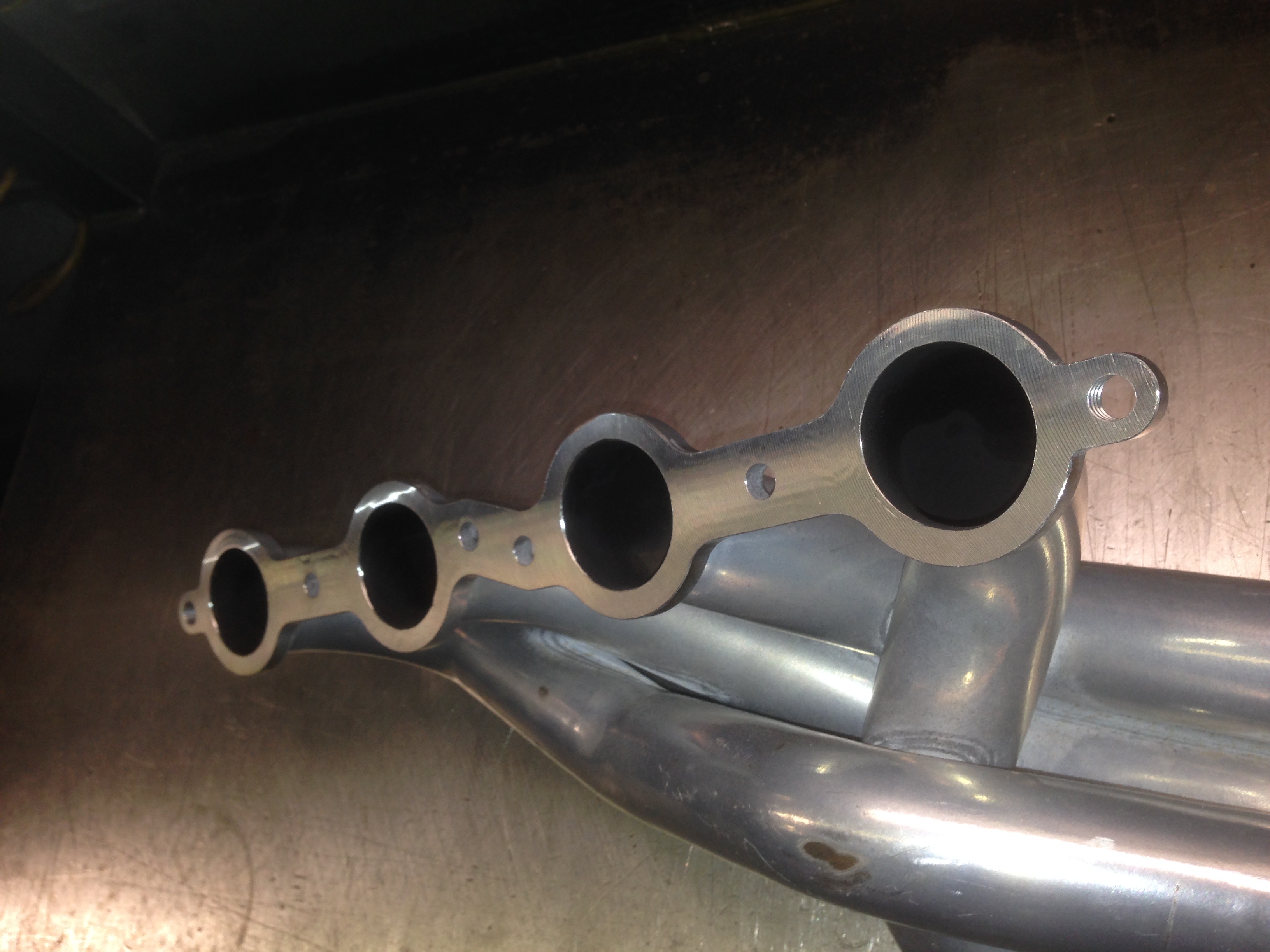

Default This is what a new header should look like

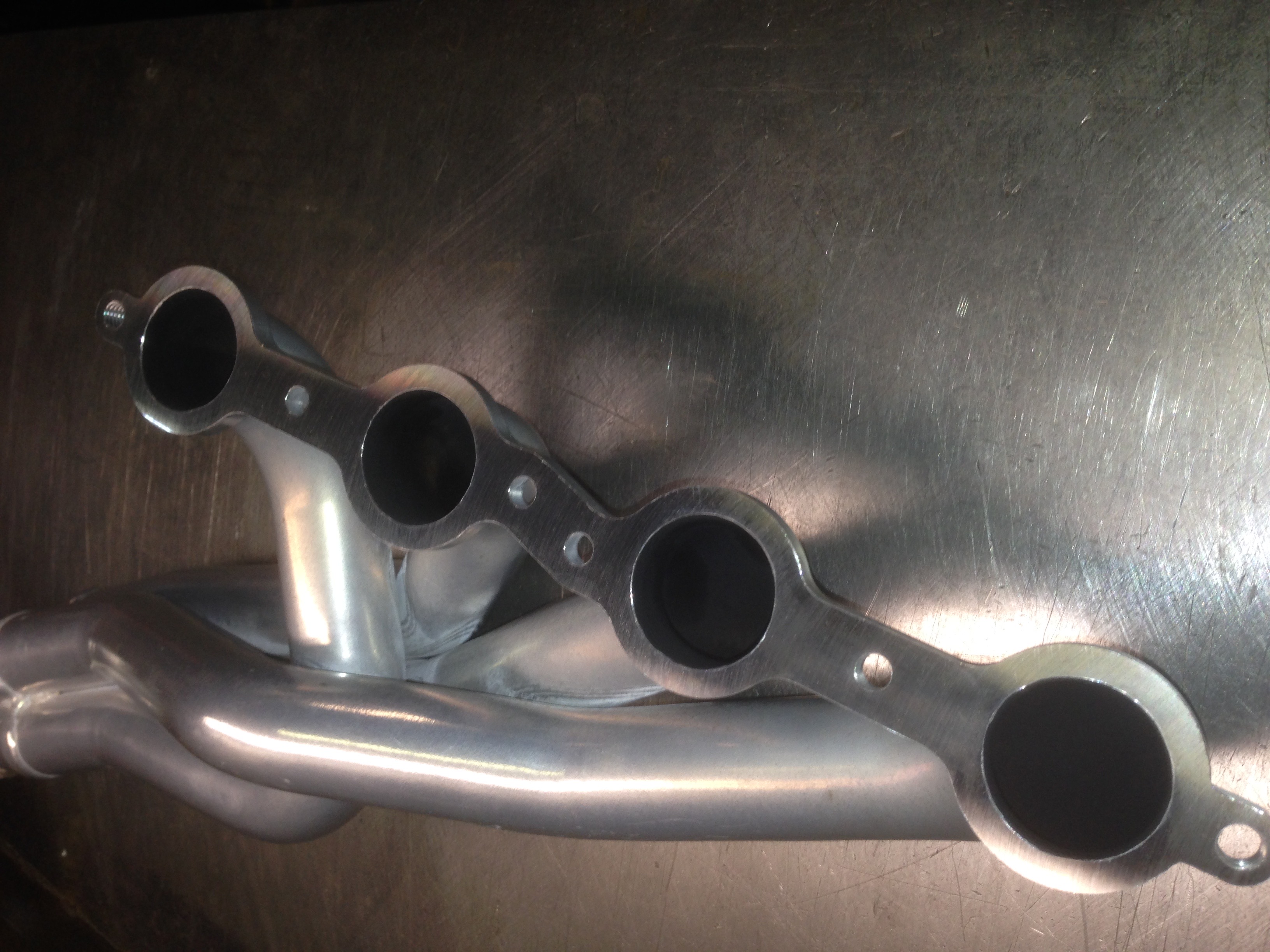

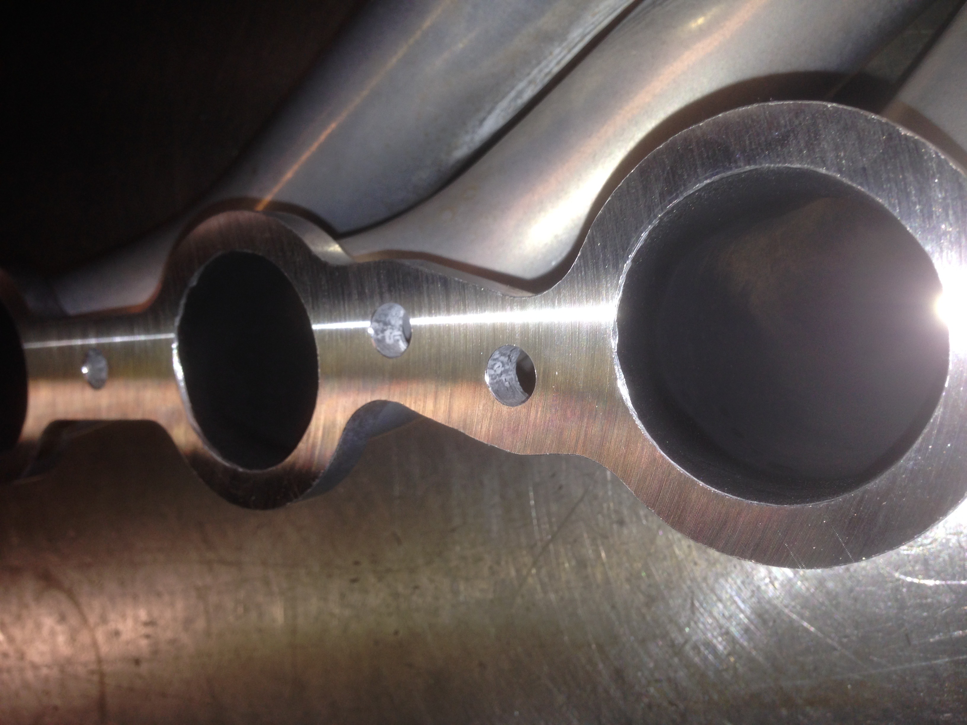

I finally got around to milling the flanges on my headers, wow did kooks do a number on the passenger side header. I had to cut off .052 cause the back port was so uneven from them grinding on it with a hand grinder. So the first picture is the passenger side the side they fixed and reinstalled and said that won't leak now. The other pictures are after I milled them, I think I'll do this every time now when I get new headers that way I know they are flat and true.
