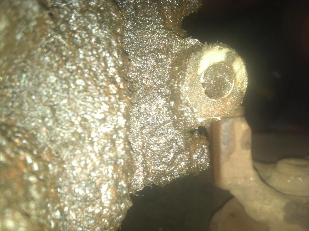

Pulling my trans for full build and I'm kinda new to the ls revolution can someone tell me what this elbow above my oil filter is ?? It just seems like something's not right about it

That's where the oil cooler block goes.

oil cooler adapter

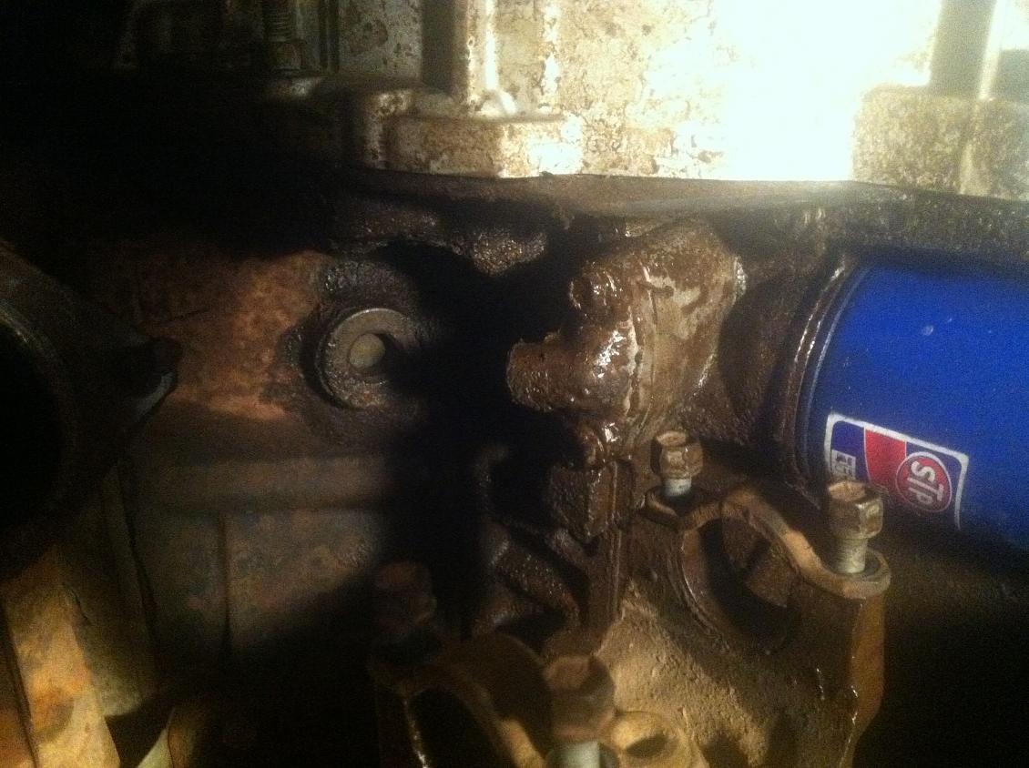

Did all these trucks come with an oil cooler? Because I have an oil mess of a leak somewhere near there ....I attached a top view shot of said block sorry about the poor quality (phone pics)

No they didn't in 1500 trim. But there is a gasket behind it that you can get from the dealer pretty cheap. I think i paid 7 bucks for mine.

Everything stock on the truck? Looks like the leak is elsewhere IMO honestly. Thats the place all the turbo guys get their oil as well. You have to drill it and tap it for that, it wont leak stock unless its around the gasket area of the oil block.

Pull the starter and check the dipstick tube o-ring for leaks. I bet that's where it's coming from.

Thats on the complete opposite side of the block^^
Ive had problems with crankcase pressure and the rear main seal before. And dam it makes a mess. Also valve cover leaking down the back of the block, and the oil pressure sender on the back/top of motor.
