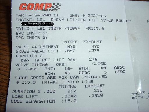

Here is the cam i have waiting
Attached Thumbnails Can I use my stock length push rods with this cam?-dscf0001a.jpg
