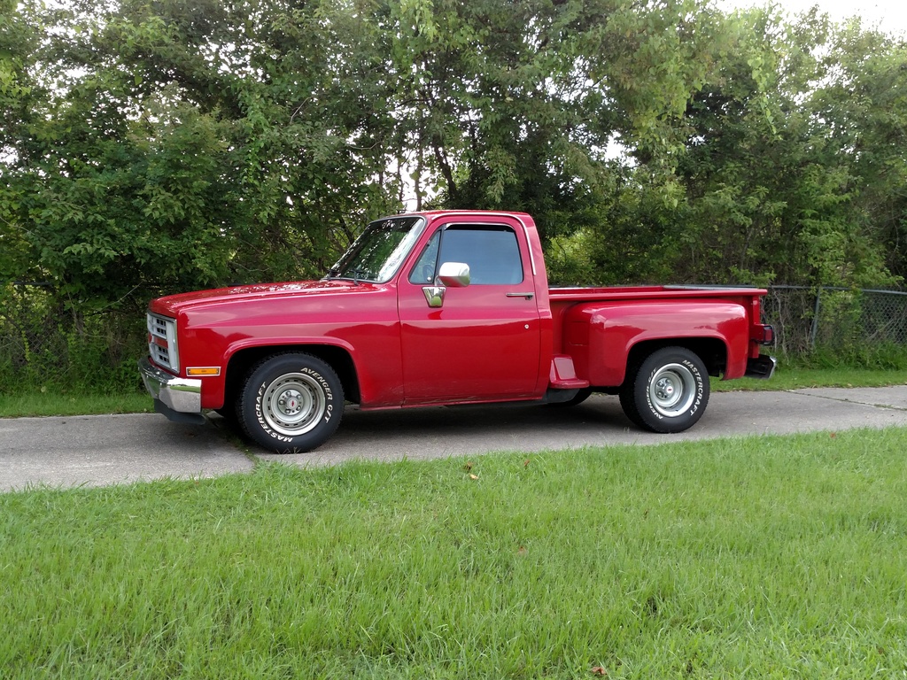

This is the truck as it sits currently

Awesome looking truck!
