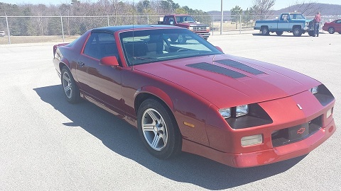

I'm building an 04 LM7 for my 89 IROC camaro swap. Looking for some suggestions for a cam, after searching and searching I couldn't find a definite answer on what would work best on my set up. The bottom end has the stock crank and rods, ARP rod bolts, 3.800" bore Wiseco flat top pistons. Using 862 heads but with 2.00" LS1 intake valves, Brian tooley spring kit... LS6 intake, Long tube headers with a T56 trans. 3.70 gears in the rear... car weighs around 3400 lbs and is used for cruising, occasional autocross or road race event.
