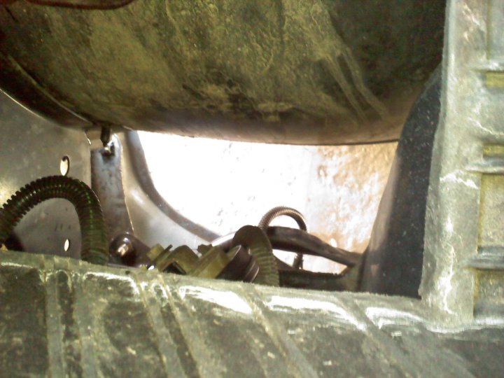

I have that same setup, but also modded the stock airbox by cutting out most of the bottom of it, as well as removing most of the metal tray below it. I have similar results as black00chev posted above, and on a WOT datalog you can see IAT's actually go lower as the MPH and RPM goes up, which is how it's supposed to work.

Sorry for the delay, but here's a shot of my airbox, looking down towards the ground, with air filter removed.
