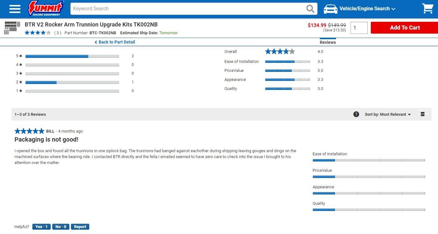

Also, it seems that I am not the only one that has experienced this issue.......
This is the exact issue that I believe caused the blemishes on the trunnions that I received. Albeit Summit shows the reviewer "Bill" gave it 5 stars but only one out of five for each of the individual areas of review? Hummm.
