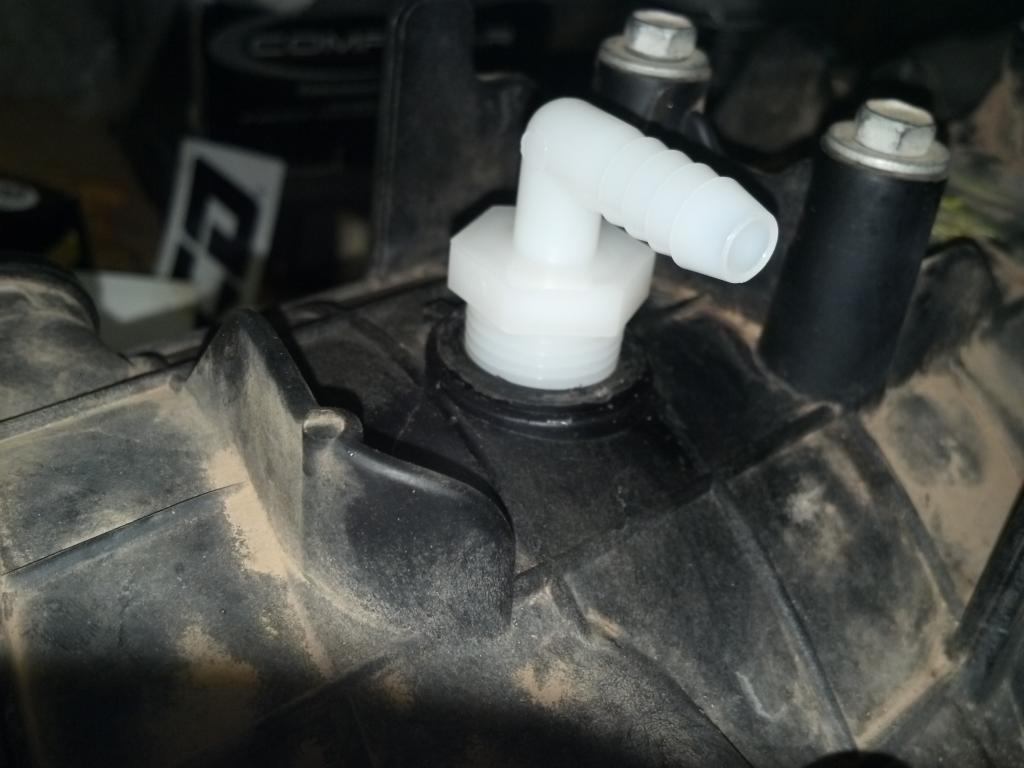

So I fixed it!
After the nipple broke I popped the rest of the cap off and scraped the surface clean. Then went to Ace Hardware and found a threaded 90 degree nipple that would fit the hole. Sealed it up with RTV and let it dry.
Should be good as new again.

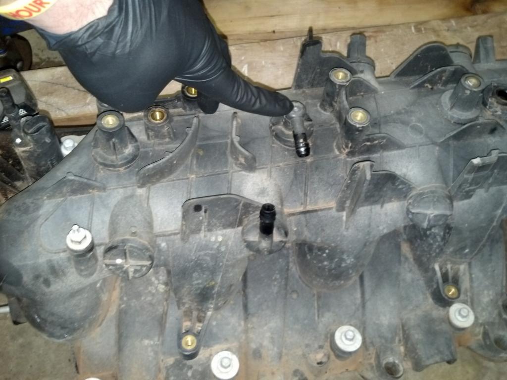

Nipple that was broken shown on an old EGR intake I didn't want to use because it was dried up and faded.

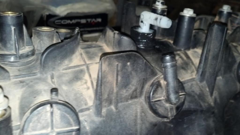

Fitment check
Screwed in with RTV on the threads and then sealed up:

Let us know the outcome. If it doesnt seal see if jb weld works next.
Old Jan 13, 2013 | 09:54 PM
viciousknid's Avatar
Where's the Beef?
Posts: 9,382
From: Dover, Oklahoma
JB weld kept breaking back off on the original patch up of the broken piece. This seems to be working just fine.
Old Jan 13, 2013 | 09:58 PM
1FastBrick's Avatar
Custm2500's Rude Friend
Posts: 14,596
Likes: 900
From: JunkYard
Did you try to tap the intake at all or just use the RTV to hold it in???
Old Jan 21, 2013 | 07:17 PM
Where's the Beef?
Posts: 9,382
I just put rtv on the threads and threaded it in the best i could without taping it. Taping it tho would be a good idea if you have the time and tap set.
It was basically a perfect fit for the hole so I didn't bother taping.
