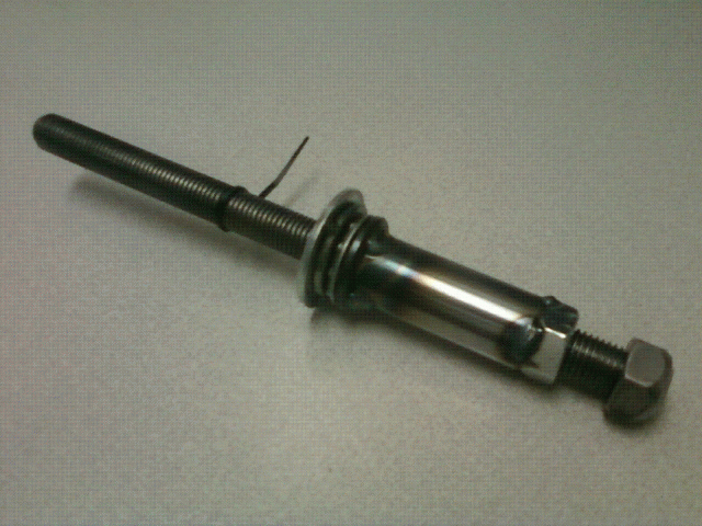

ok the hard part, how did you guys get it back on? Last time i did this the engine was out of the truck so I could tap it on with mallet untill i could screw the bolt in a few threads to seat the pulley

Buy or make an installer tool. Don't even take a chance on ruining a crank.
You can get one here, or maybe somebody can loan ya one... Cheap compared to jacking the crank up
Scoggin Dickey Parts Center SD6628 - LS Balancer Install Tool | SDParts - 1-800-456-0211

^^ used this 2 weeks ago when we installed my SLP Underdrive Pulley as well. Works like a charm. Of course a buddy of mine owned one, so that made it easy.
