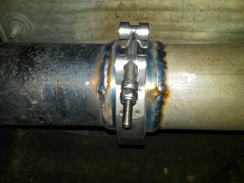

Old Apr 18, 2014 | 07:54 AM
RezinTexas's Avatar
Joined: Jun 2011
Posts: 1,292
From: Houston
I don't know the brand, however here are some pics.

Cut off the 3 bolt collecter and weld on the v-band = no worries!!
