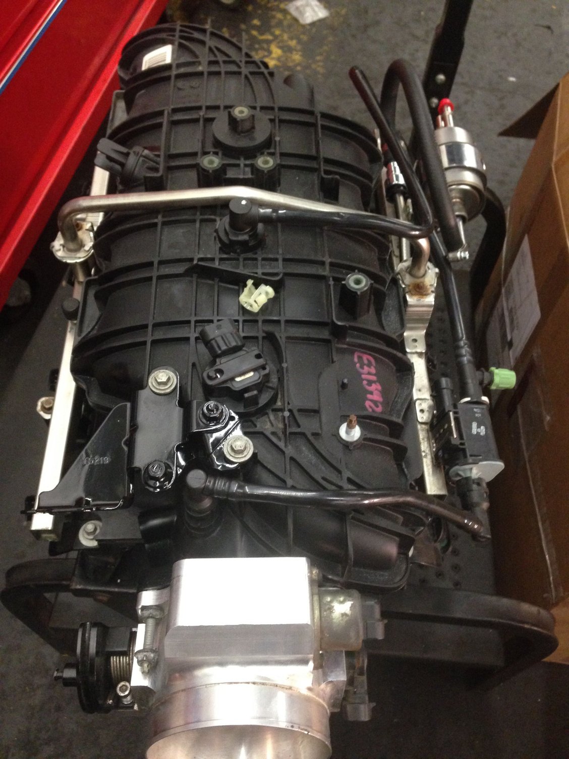

https://www.performancetrucks.net/fo...-6-0-a-540712/
Heres one thread....ive done it to my 99
Heres my nnbs rectangular port intake....

The cable bracket just needs to be played with to be made to work... Speaking of which at somepoint i need to make something better than what i have but.... At the moment it works
