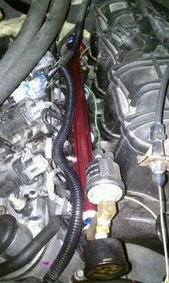

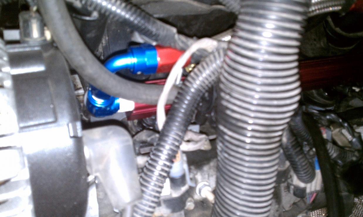

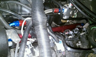

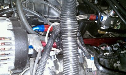

hey john got a few pics for u off cell phone again but all i got for now
Attached Thumbnails Anyone have issues with the cross over line hitting the-tbss-intake-setup2.jpg   Anyone have issues with the cross over line hitting the-tbss-intake-setup3.jpg   Anyone have issues with the cross over line hitting the-tbss-intake-setup4.jpg   Anyone have issues with the cross over line hitting the-tbss-intake-setup5.jpg

Thank you brotha.. I am thinking I can slide by with the fittings I have.. Like Skeet said using the short 90's he was able to get it to work.. I have the short style ones..

Ur welcome and sweet good luck post some pics when u get that bad boy in! One of the mods I really like the most I did.

lol sorry John, sent ya a pm, my engine is disassembled right now so pics arent gonna happen, waiting on another set of heads, at first i used a long radius 90 then trimmed the plastic on back of alternator, then later on i ran across a short radius 90 that worked fairly well. as soon as i get things together ill post pics, but im sure youll have things figured out by then!
