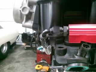

Red face Anyone have issues TBSS intake, aftermarket rails( post pics)
Hitting the alternator when running after market rails, front cross over?? Some one had told me that it will hit.. I am going to try and finally get this intake on soon..

So do ya think this will clear? They are short 90's
Attached Thumbnails Anyone have issues with the cross over line hitting the-imported-photos-00002.jpg   Anyone have issues with the cross over line hitting the-imported-photos-00003.jpg

No I dont think so. Not on the Alternator side

im the one who told u they will hit and yes the short ones will to thats y i just did mine on the back side little more pain with running lines to it ill see if i have any pics of it for u guys

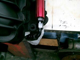

did it work
Attached Thumbnails Anyone have issues with the cross over line hitting the-tbss-intake-setup.jpg

hey it worked first pic i put up on here of the cell phone lol here u go john how mines ran

yes post up please.. The way all of the stuff I made to hook right where the factory lines unhook off the rails.. Is it a just hits or like all up in the alt??

mines barley hit and i was like wth can i do and then pops came and looked was like hey try this idea and thats the pic i post is his idea i think it would out ok
