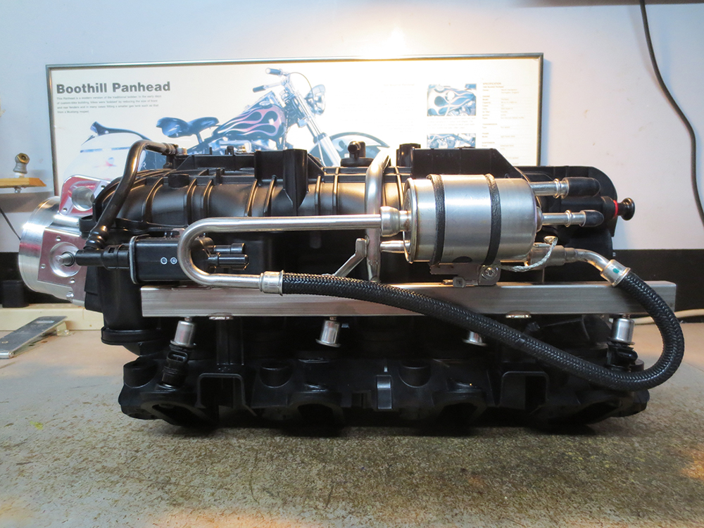

With a return system it's a little more work and it can get expensive. The Wix Corvette C5 filter/regulator (33737) is $45. There are a few different ways to plumb the outlet from the filter to the fuel rail. If you just connect the filter directly to the rail the lines get kinked against the firewall. The easiest plug & play solution is using a fuel feed line from the Corvette that connects to the fuel tank part number 25948212 It's $65 new. Then you need the injector flow rate changed in the tune because you no longer have a vacuum referenced fuel regulator... that cost will vary if you don't have HP Tuners or EFI Live.
You can see were I mounted the filter back on the rail, back from the rails inlet. The long fuel line is the Corvette mentioned above. I bought my filter/line from a member here saving some money. I have HP Tuners so the return type system conversion wasn't to painful money wise.

Thank you! That's what I'm planning, but your photo makes it ten times clearer. As always, the theory is simple "use a Corvette filter" but actually engineering the application is where it gets messy. Greatly appreciated.
