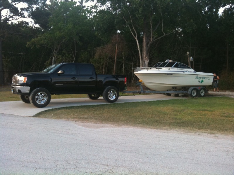

Attached below is a picture of what I would tow on a regular basis. It was a 21ft sea devil. My tranny temps hit 205 degrees last summer because we had the bed loaded with weekend gear and there was four people inside the truck. My stage 3 pro series TC drove like stock until I hammered down on it. I used my truck and never had any issues with towing or racing. However, I still say install the TC first, then regear. Add the cam later on when you can afford pushrods, valve strings, etc.
