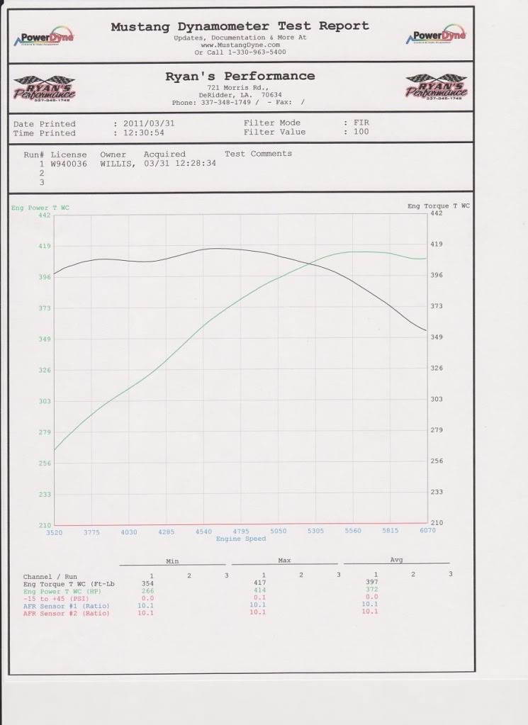

Lq4, milled 243's, 228/233 .595/.578 113+4, 42#inj,nnbs intake,87mm tb,k&n cai, efans, pacesetter lts, dual 3", 3200 stall, 4:30 gears.
I'm running a stock converter right now, and it feels good. With some traction it would be a turd, but I'm surprised in how it feels..
ET in sig..
ET in sig..
whats the torque look like below 3500rpm?
