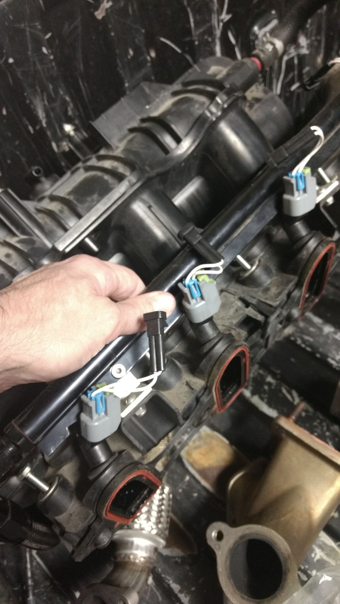

You can probably use the Holley fuel rails. Just make some brackets from angled aluminum. Mount the brackets to the intake itself.
This is how I did it. I can post better pics if you need them. The factory fuel rails mounts are cut off.
This would be a better setup, imo, over making the factory stuff work. I also run an afpr. It is still mounted to the firewall tho.
