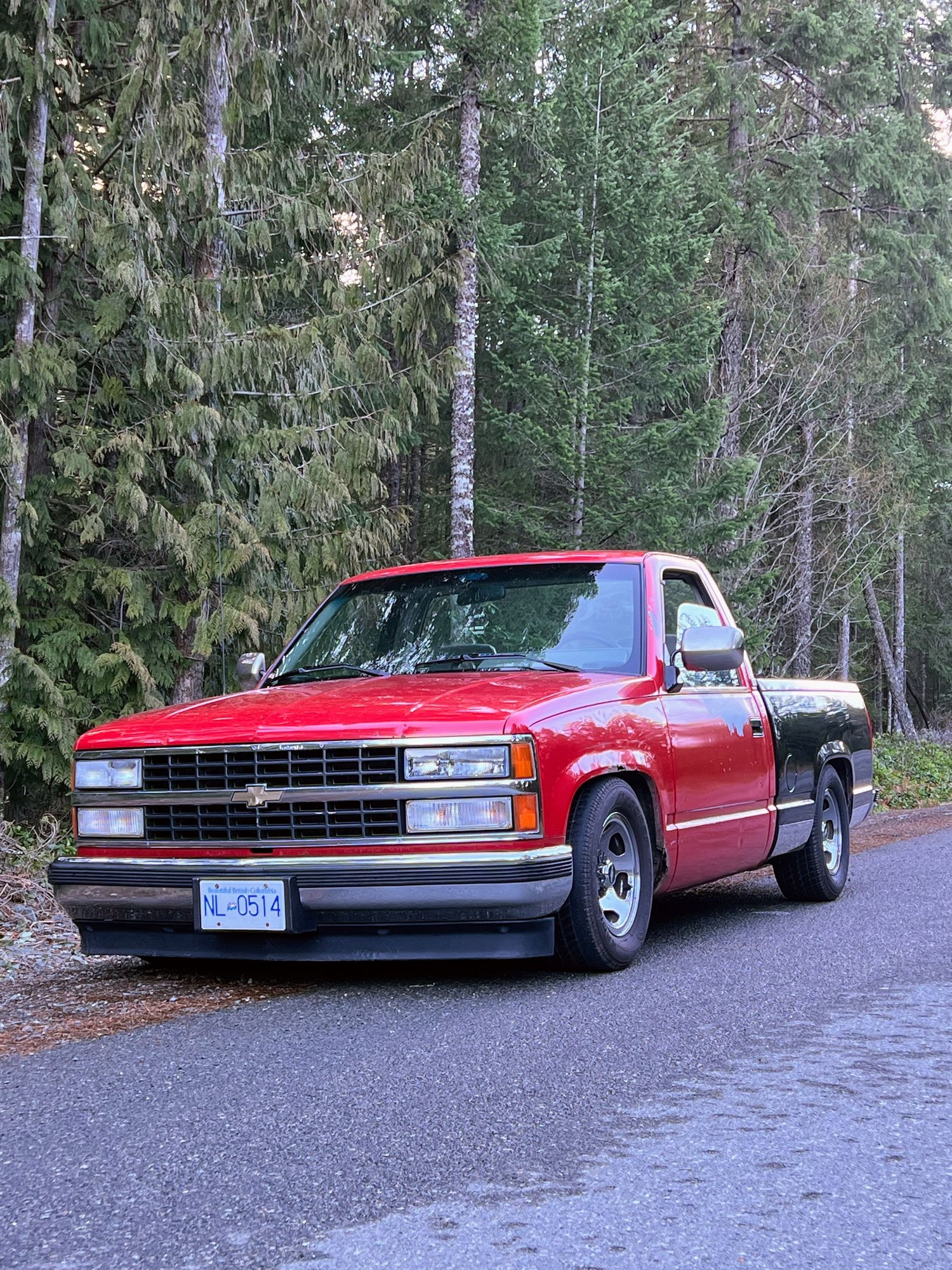

Hey I’ve been having this problem for a couple weeks now since weathers been heating up here. Engine is a 2006 5.3 L33 DBW. It’s a swap engine into a 1992 C1500. Transmission is a TH-350. I’ve done all the work so I’m familiar with how everything was done.
Truck starts great in the morning, good idle, and drives great under acceleration, cruise and WOT for the first 25-30 mins. Usually it drive just fine, has a good tune. Anyways, drives normal until the truck reaches operating temp and the engine bay gets hot. Once the engine is hot, every time I let off the pedal coming up to a stop or at low speed the engine idles really low (200-500 rpm, 750 idle set at), and truck starts shaking violently and tries to stall, sometimes it does. Starts right back up if it does. Once i give it gas it accelerates/drives fine again until the next stop. What’s the cause?
Parts that are new within last year:
Maf (cleaned recently, dry air filter)
Temp sensor
Map
Spark plugs/wires
Alternator
Battery
Intake Manifold gasket- felpro
VSS- dakota digital th350 to LS pcm
O2 sensors
Vacuum hoses
Fuel filter/Pressure regulator
Fuel pump 340lph- Holley
(Everything Ac Delco/Delphi unless listed otherwise)
DBW Throttle body isn’t new, but was cleaned within the last couple months. May have some oily stuff on it by now.
I’ve researched for two weeks and tried seemingly everything and fixed nothing. What do you guys think could be causing this? I can clarify anything if you need more info. Thanks a bunch!
