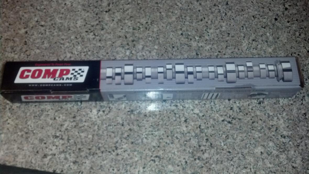

its been a while.. the trucks been sitting and never really had enough time to get around and finish it up! finally got my 228r cam @110.. really excited to see what itll do after the install in a couple weeks

How's it run with the 4.56's and 4000 stall? I went with 4.11's/ 34-3600 stall. I wish now I'd went with a 4000.

You did get stiffer springs too correct?

will do! and yeah ordered the cam package from tsp with springs and rods

finally got the truck back today.. it runs like a champ.. felt like i couldnt go with any better setup that i have now.. really satisfied with the 228.. performance and work was done by Jake and John out of LSX Performance and Tuning out of Sublette Ks. I will try to upload videos. First video is the truck idling @110lsa, 2nd video is a quick punch by John while tuning the truck.
