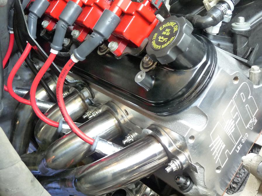

on my 2001 truck with TSP headers I'm running MSD 32829 wires. Just bend them to fit around the headers and they fit perfect. $70 at any parts store. I also wrapped some reflective tape around the lower boots, but that may not be absolutely required, there is plenty of clearance.

Is that just aluminum tape you are talking about?
Old Jun 18, 2013 | 05:48 PM
RezinTexas's Avatar
Joined: Jun 2011
Posts: 1,292
From: Houston
not sure exactly what it is. It seems to be some sort of thin fiberglass weave cloth with a shiny foil on one side and adhesive on the other side.
I got it at a parts store (oreily's) in the same section as header wrap and exhaust gaskets, etc.
