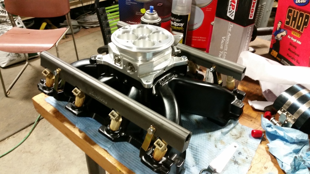

I plan on using speed density, im using a 14in breather that I drilled and installed the iat into
