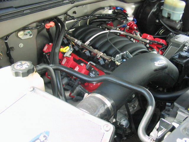

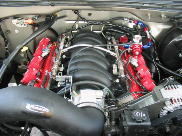

Finished last week.
Attached Thumbnails 408 in truck with pics-engine1.jpg   408 in truck with pics-engine3.jpg

Looks good....what kind of alt/ps bracket is that?

Chris, thats either a C5 or C6 Corvette bracket... along with, I assume, the rest of the vette accessory drive

Cool, good to know. I'm gonna have to make the leap to a different intake manifold at some point. I love the way the car manifolds look.

Nice but no A/C would kick my *** in the summer

Alt bracket 05-06 corvette ls2

Left a/c off for now, running out of time for LSX race.
Dyno about dozen pulls last night.

Looks good! What did it dyno?

2nd pull was 477rwhp and 496rwtq @5200 rpm for both. Seemed to like 11.8 AFR fell off with 13.0 AFR to 430rwhp?? I really need a bigger cam, and I have two being made right now. I will not put them in till after the LSX shootout.To short of time to tune properly..
