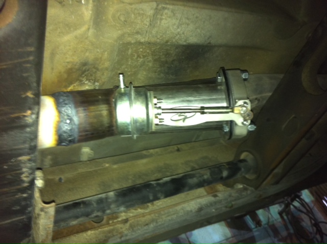

I have SP 3" cutout with boost activated gate and it works great.
The good thing is at low boost it's closed, so, there is good back pressure. Mine opens at 9psi. I can hear loud sound at 9psi.
SP web site says it starts to open at 5psi and will be fully open at 17psi.
While on the dyno after it was newly installed, it did not open. So, I foreced it open to do the dyno run and there was huge difference between the two dyno runs. Gained a lot but can remember exactly as it was couple of months back. But one thing for sure, boost jumped from 15 to 20 psi with same WG setting. So, had to adjust my boost controller down to 15psi after the SP cutout install.
