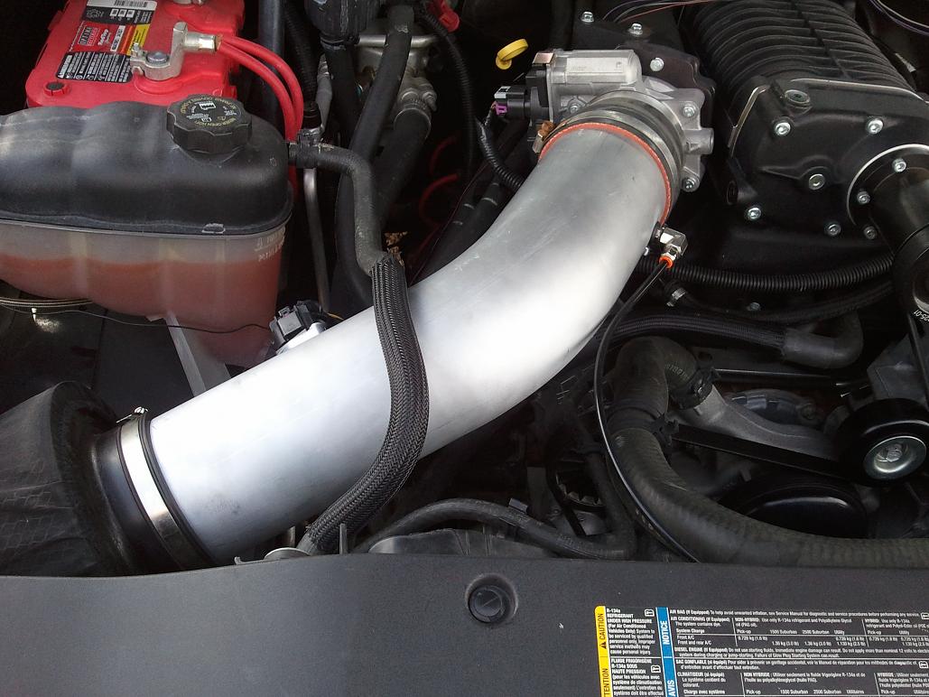

I recently put some heads and a cam on my truck (2008 RCSB with a Vortech/Lysholm twin screw). After raising the rev limiter and shifting at 6300 I noticed my boost was really dropping off at high rpms (down to 7.5 lbs at higher rpms from 10 lbs). I figured I had two options: upgrade the supercharger inlet or upgrade the intake tube, MAF and filter. I'll eventually swap over the the Camaro supercharger intake as well, but I am pleased to say the truck holds 10 lbs of boost all the way to the shift points now. I also removed the plastic that sits by the side of the radiator so that there is a straight shot to my filter through the grill. The truck pulls much harder at the top of each gear now.
I used a 4.5" OD 11 gauge aluminum tube with a 45, a LS7 MAF and a AFE dry filter (4.5 inlet 8.5" at base and 7" at the end and 8" long).
Well worth the $ for this upgrade. The aluminum bend was $29, the filter was $87, the MAF was $69.

Very nice! You running ls7 throttle body?
Originally Posted by damianldaigle
How did you bend it?
Pretty sure he bought pre bent elbow

Yeah pre-bent. I replied to your PM.

[QUOTE=beastmode;5138742]Very nice! You running ls7 throttle body?
Thanks.
I'm running the stock 87mm truck throttle body. I ordered the Camaro intake this week (from throttle body to supercharger). It looks to be around 4". After I get the new intake and see what it gives me, I'll look at upgrading the throttle body.

Btw - I noticed a big retsriction with the pre-filter. It might be ok for daily driving or winter, but I had to take it off at the track to get the results I had before I installed it.

Nice work. A low restriction inlet always helps the pd superchargers. I noticed a 1-1.5psi difference from a 3.5" intake tube and stock 87mm throttle body to a 4" tube and 95mm tb. You may want to think about fabbing a box or shield to isolate the filter from the engine compartment. The top mount twin-screws have an issue with heat anyway so the lower the inlet temps, the less that little intercooler has to over come.
