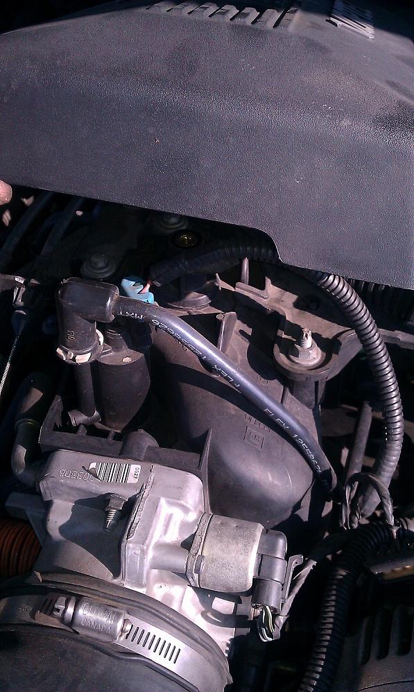

What do i do with this? Name:  Evapthing2.jpg

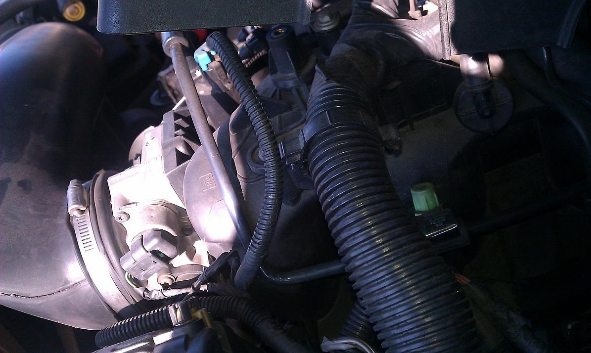

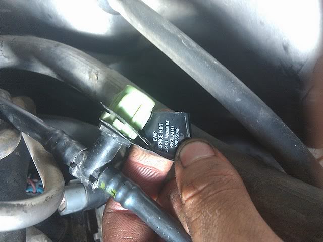

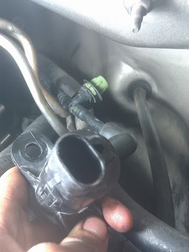

Where does this go? Name:  wheredoesthisgo.jpg
Size:  72.4 KBName:  wheredoesthisgo2.jpg

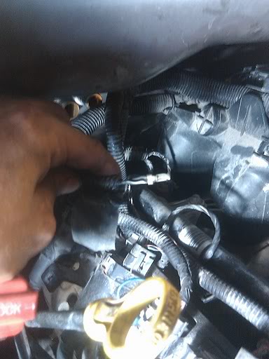

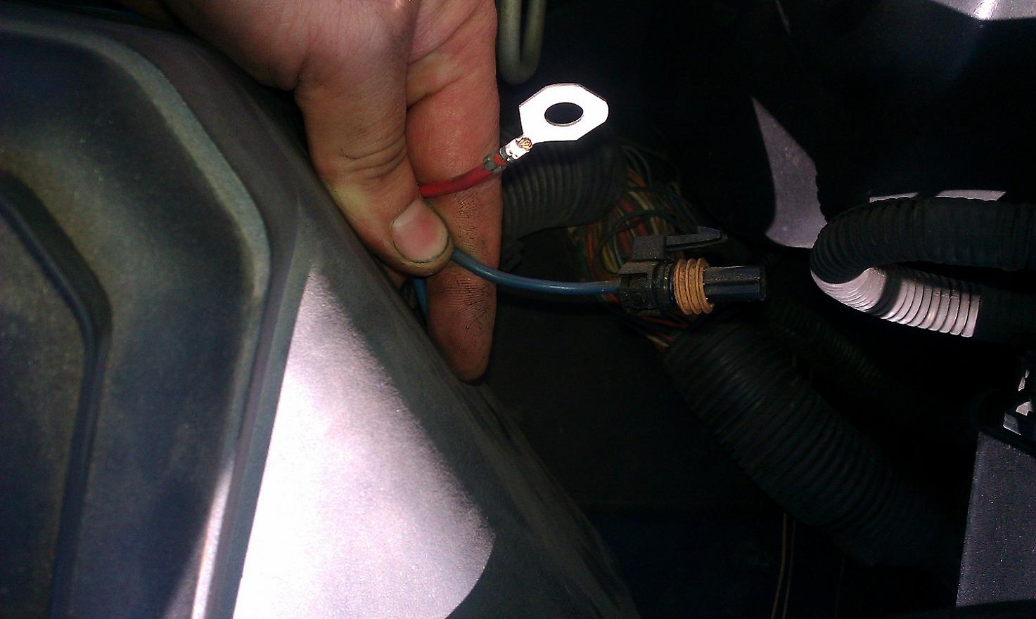

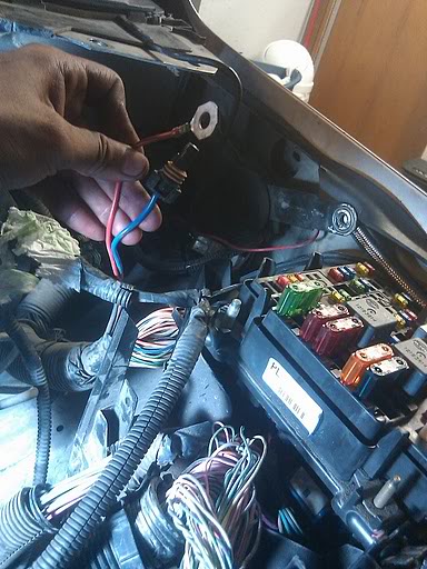

This looks like a ground wire but where does it go?

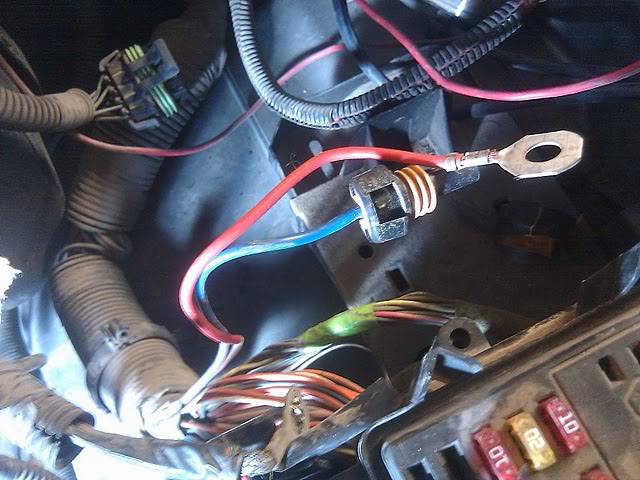

You can't just expect response in only 2 hours. The solinoid goes on top of the intake manifold. leave the green cap on it is supposed to be there. Not sure wich year your doing but there all similar. the blue wire is a spare and does not need to be pluged in. the red is also loose on mine. 2000, 5.3 bone stock. If your patient I will take pictures for you and up load them here

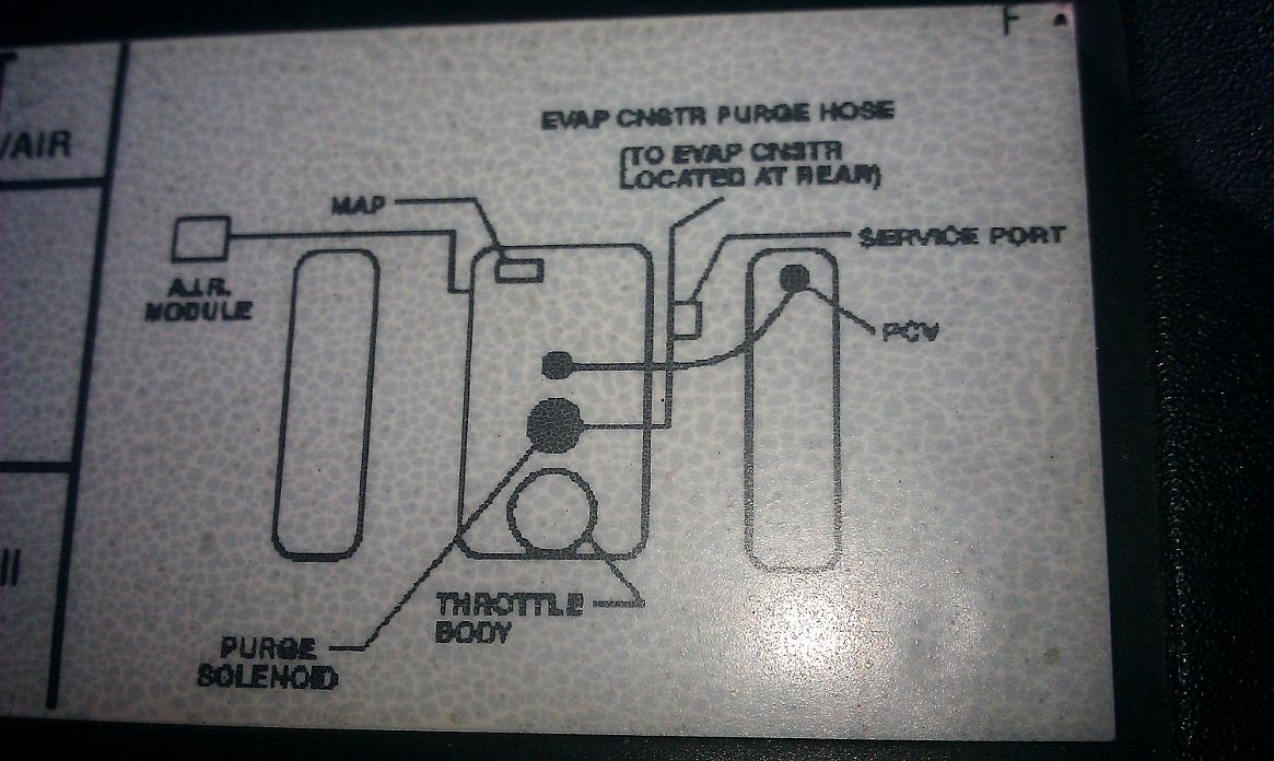

Here is what it should look like. The purge solinoind sits on top of the manifold as shown. The plastic line runs to the back of the block and connects to another hose that connects to the vapor canister.
As far as the wires shown, It's to much work to get the braket off the fender to fully remove the fuse box cover but here is the wires pulled through the bottom of the cover. There just tucked up underneath there in the wireing.
Attached Thumbnails 4.3 5.3 swap is almost complete!! PICS-imag0358.jpg   4.3 5.3 swap is almost complete!! PICS-imag0359.jpg   4.3 5.3 swap is almost complete!! PICS-imag0361.jpg   4.3 5.3 swap is almost complete!! PICS-imag0356.jpg

Need a better picture of the Ground wireing you are suspecting. Wire colors and Year the harness came from would help. But if there ground wires most likely the go to the back of the block...

The blue with connector and red with eyelet are trailer wiring

Your said everything was hooked up. Including the wire you suspected as being ground???
Yeah :/ Except the o2 sensors because i didn't wanna but the cats on, but i doubt that maters.
