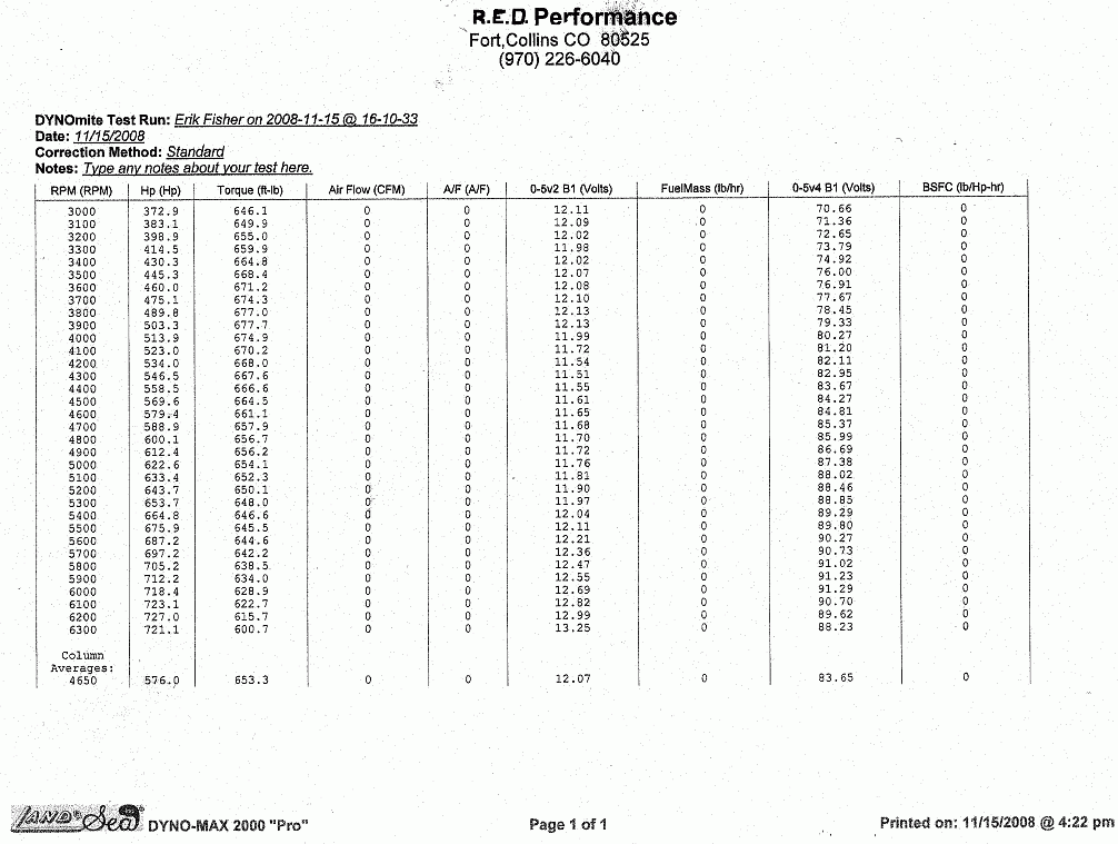

We originally went .03 over on a 408 stroker, 6.0 liter iron block. Worked great, put a tvs 1900 on top and made 727 hp and averaged 650 ft/lbs on 6.5 lbs of boost. No oil burning and my gas mileage went up over the old 6.0. Now the important news, broke a value spring and dropped a value in the motor. Beat the crap out of 5 pistons and scratched 5 cylinders. The good news is now we can still use the block without a sleave and bore to .04 over. At .06 over if something goes wrong you are **** out of luck. Go .03 over, stroke it correctly and you'll enjoy the **** out of it.
