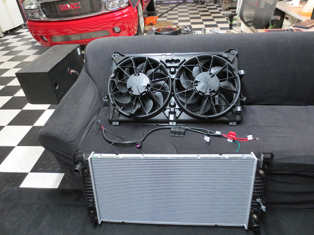

On the GMT-800 (99-06) trucks there are three sets of bolts on the core support. Inner for the shroud then the 28" then the 34" on the outside. I'm not sure about a shroud for the 34" radiator as most do the e-fans when swapping the 28" to the 34". The newer trucks 07+ with the heavy duty cooling system have an extra fan blade on both the fans. These newer fans bolt directly to the 99-06 trucks and fit perfectly with no mods necessary.
28"

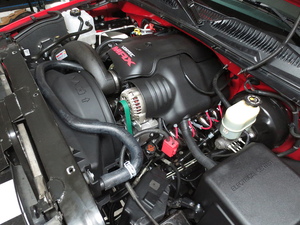

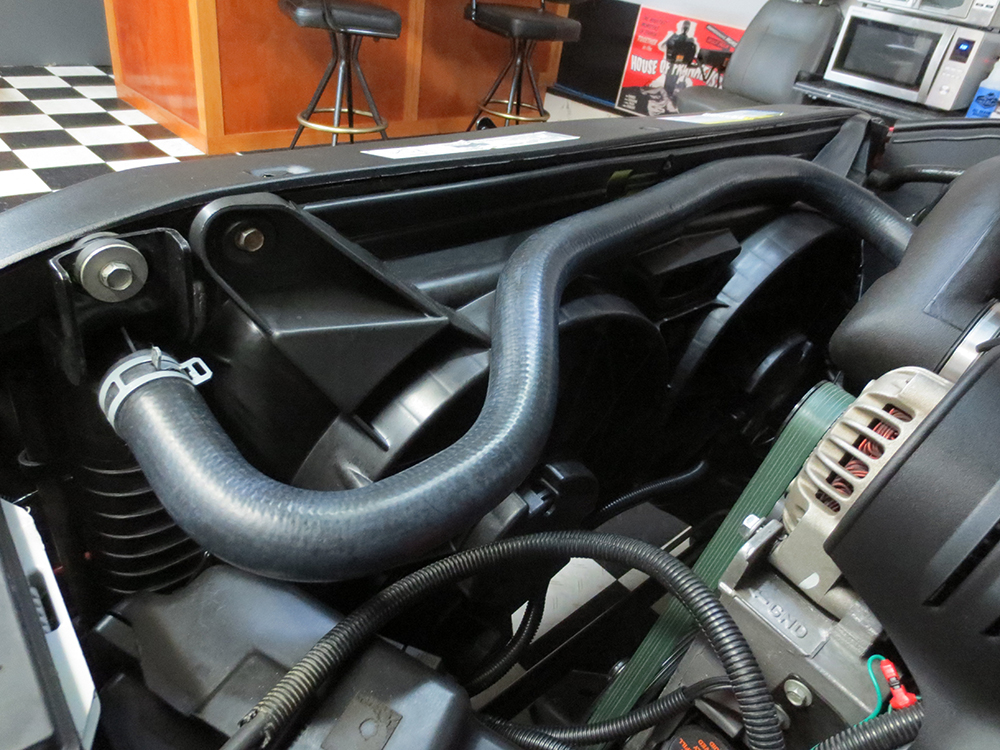

2000 GMC with the newer 07+ HD fans and 34" radiator.
