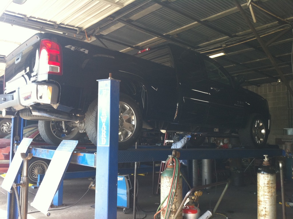

I ran a 6.2 stock catback on my 2011 5.3/6spd. Dynoed 315 tune and catback only with a K&n drop in filter. Stock y and cats. I did this swap literally the first day from picking the truck up from the dealer...
That seems convincing!
