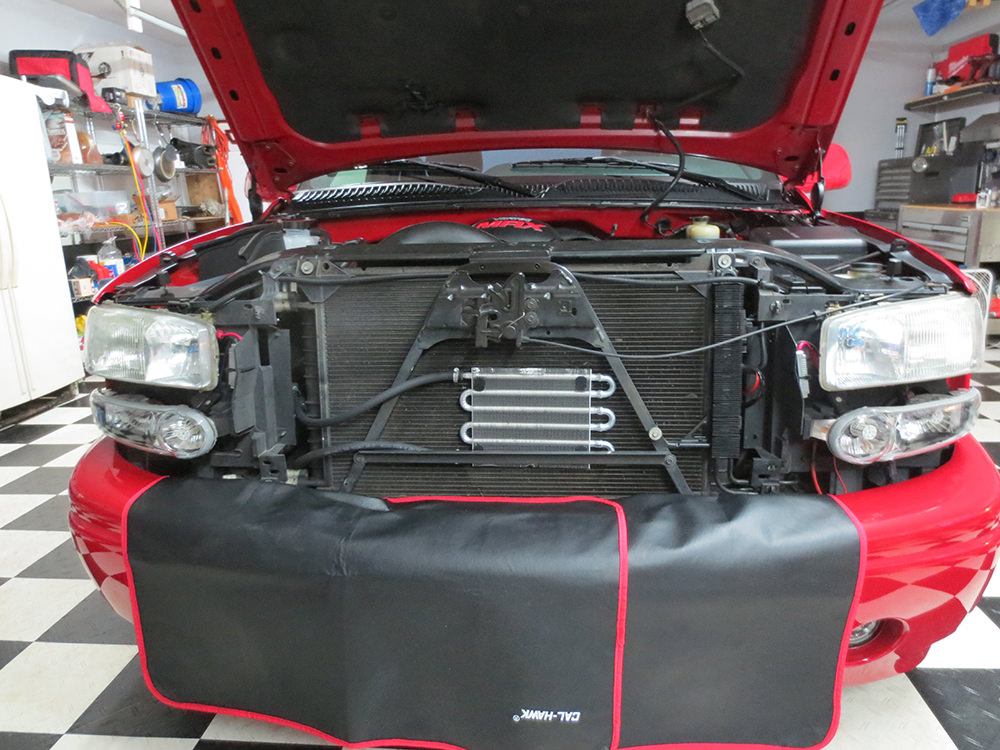

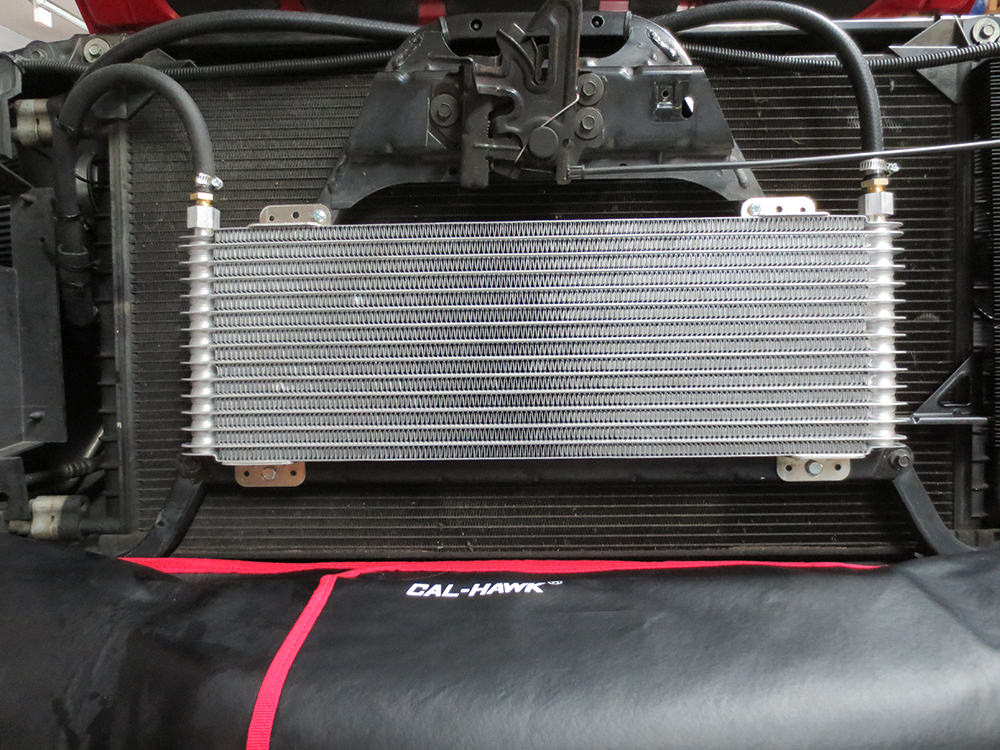

I'll add my 2 cents to this conversation lol
If you do get the level II Performabuilt 4L65e they will send you a very small cooler that you must use or they will void the warranty. They also want you to bypass the original cooler in the radiator. I'm running a Circle D 3200 stall and with the small cooler I was getting transmission temps well over 200* when summer rolled around. Switched the dinky cooler for a 40K Tru-Cool and the temps never see more than 170* beating the hell out of it on a 100 degree summer day. With towing and more heat from the stall... the 40K will serve you well.
Compare the tiny sized Peformabuilt cooler to the 40K

Da fuq @RedXray !!
I'm surprised that cooler cooled it that well tbh.
For OP, the TruCool 40k is the way to go.
