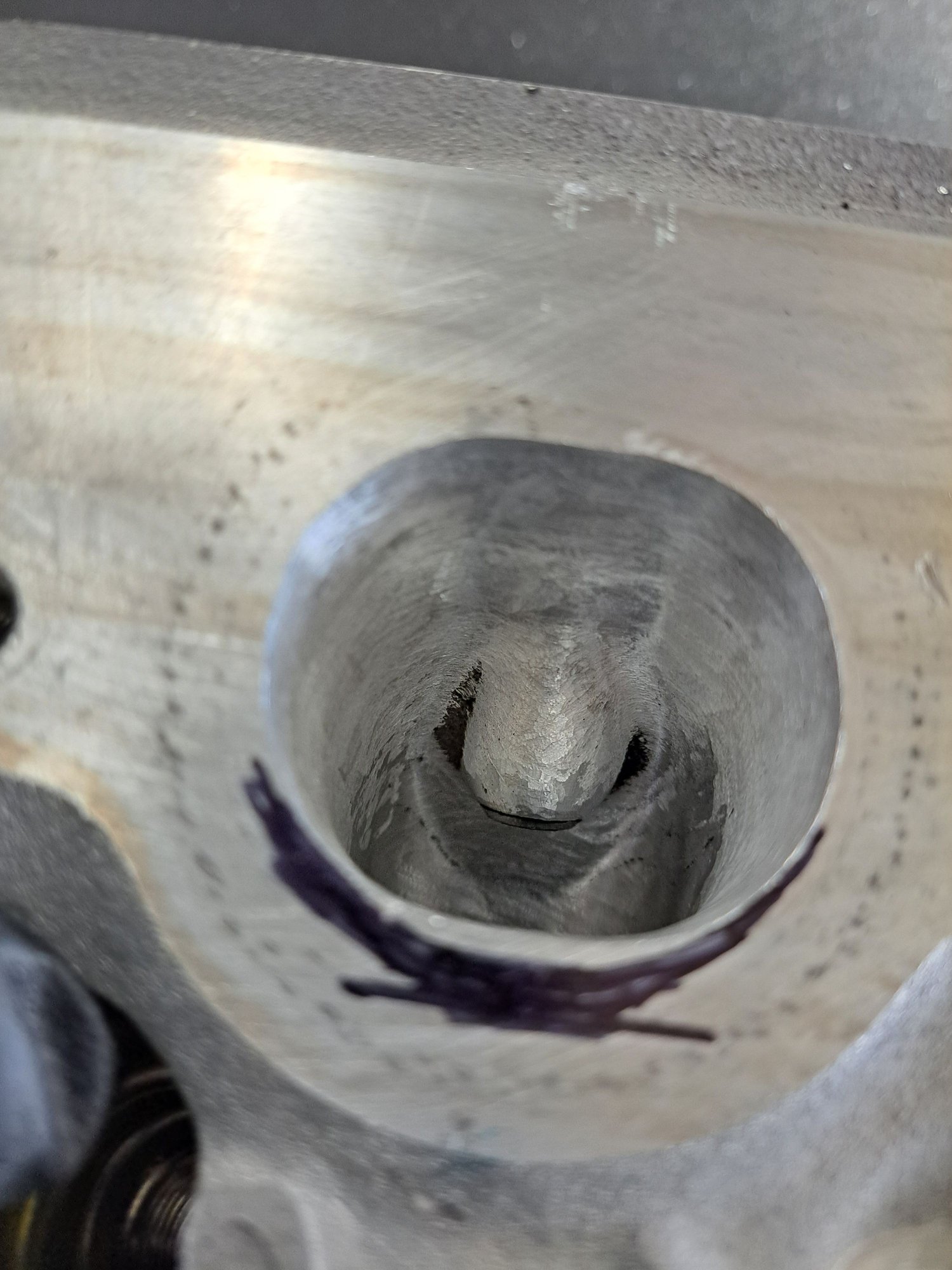

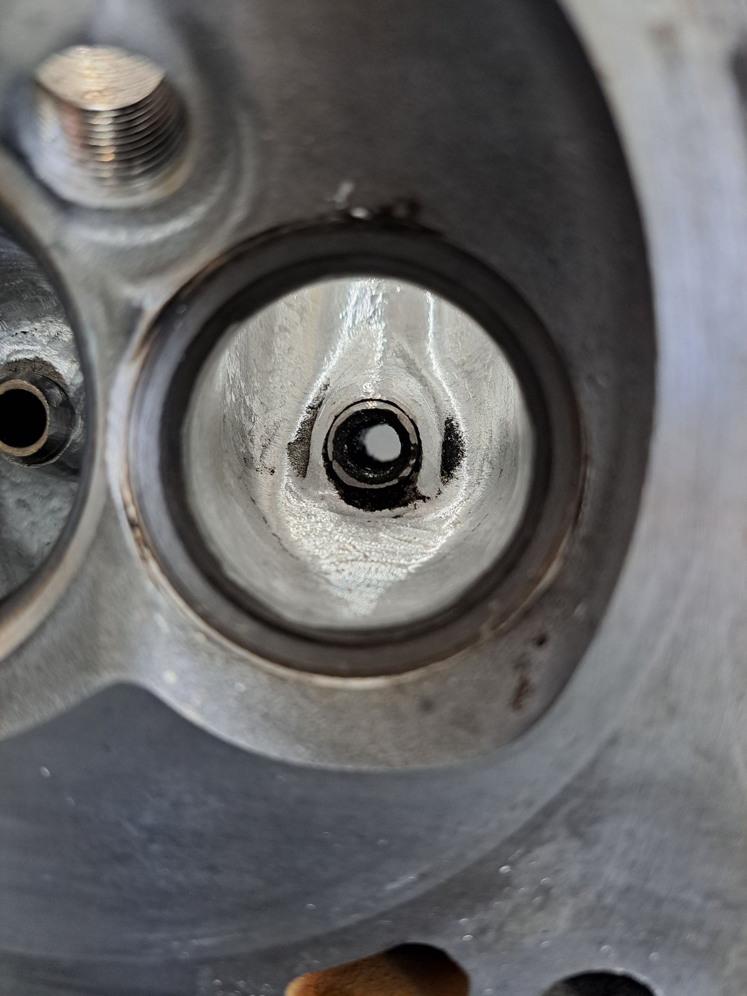

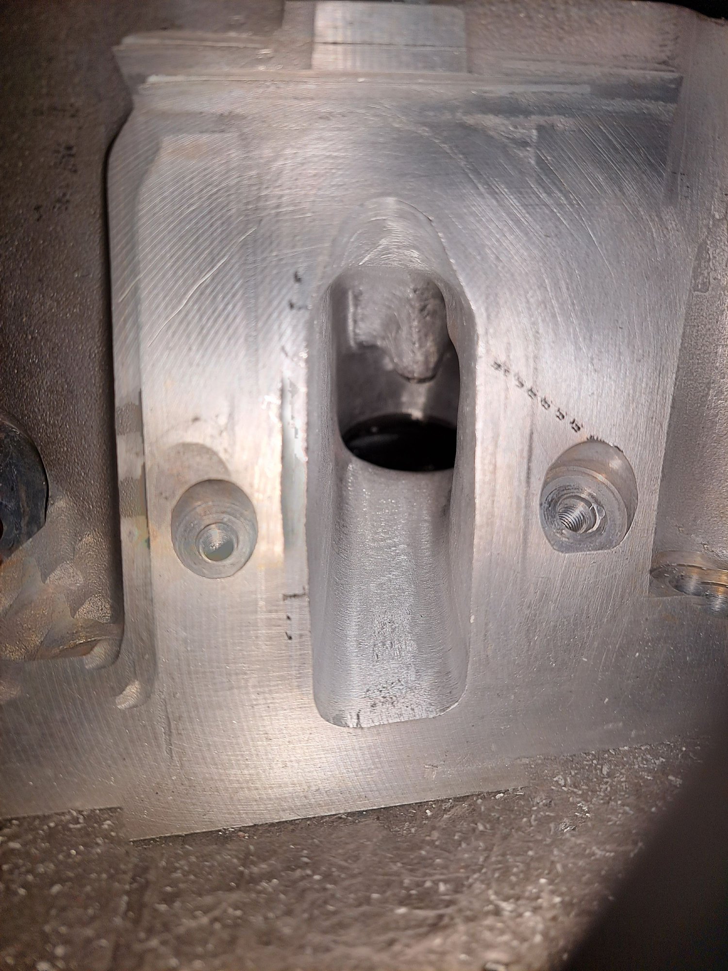

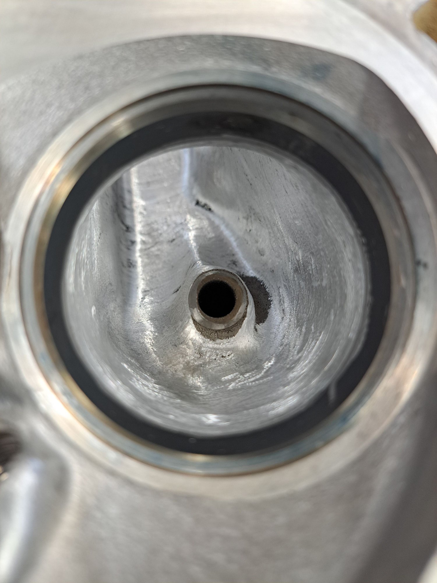

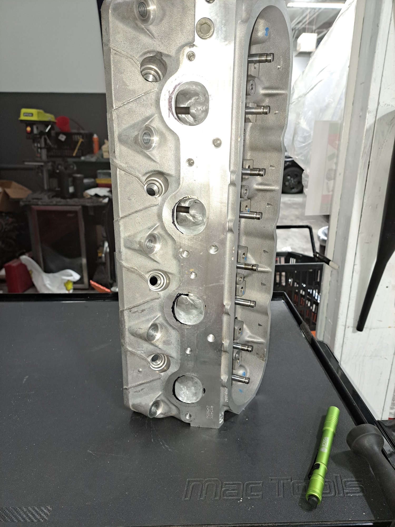

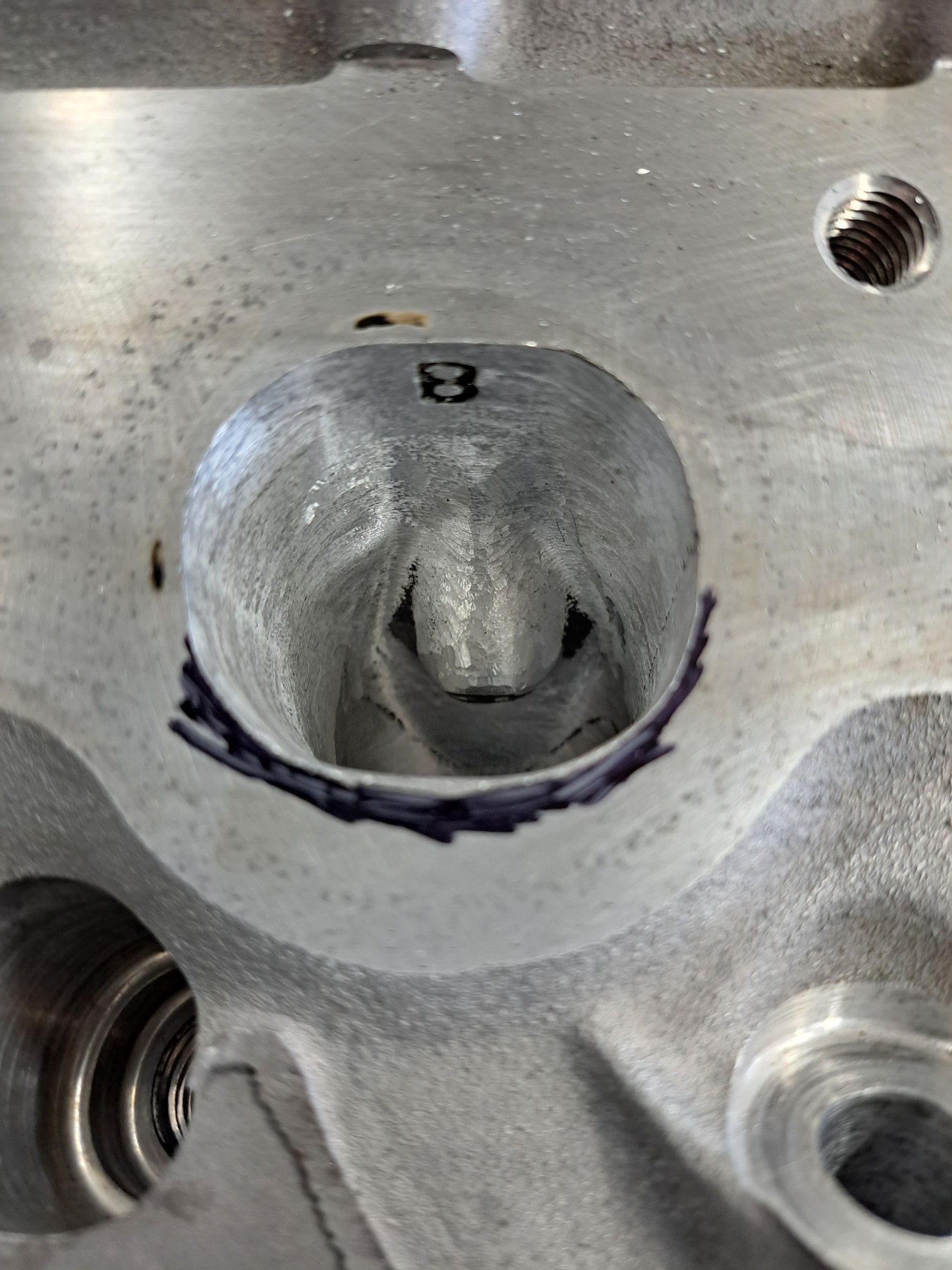

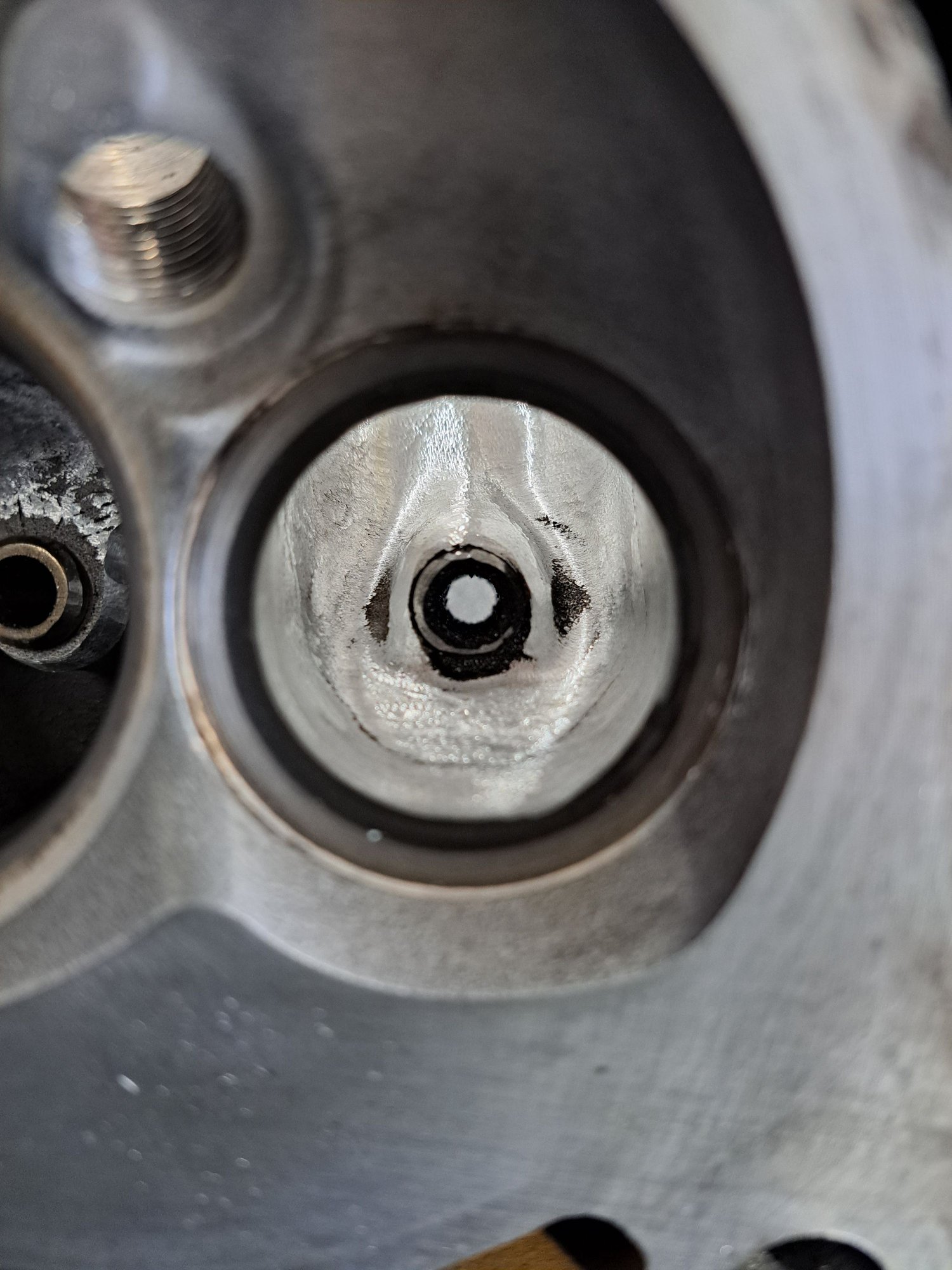

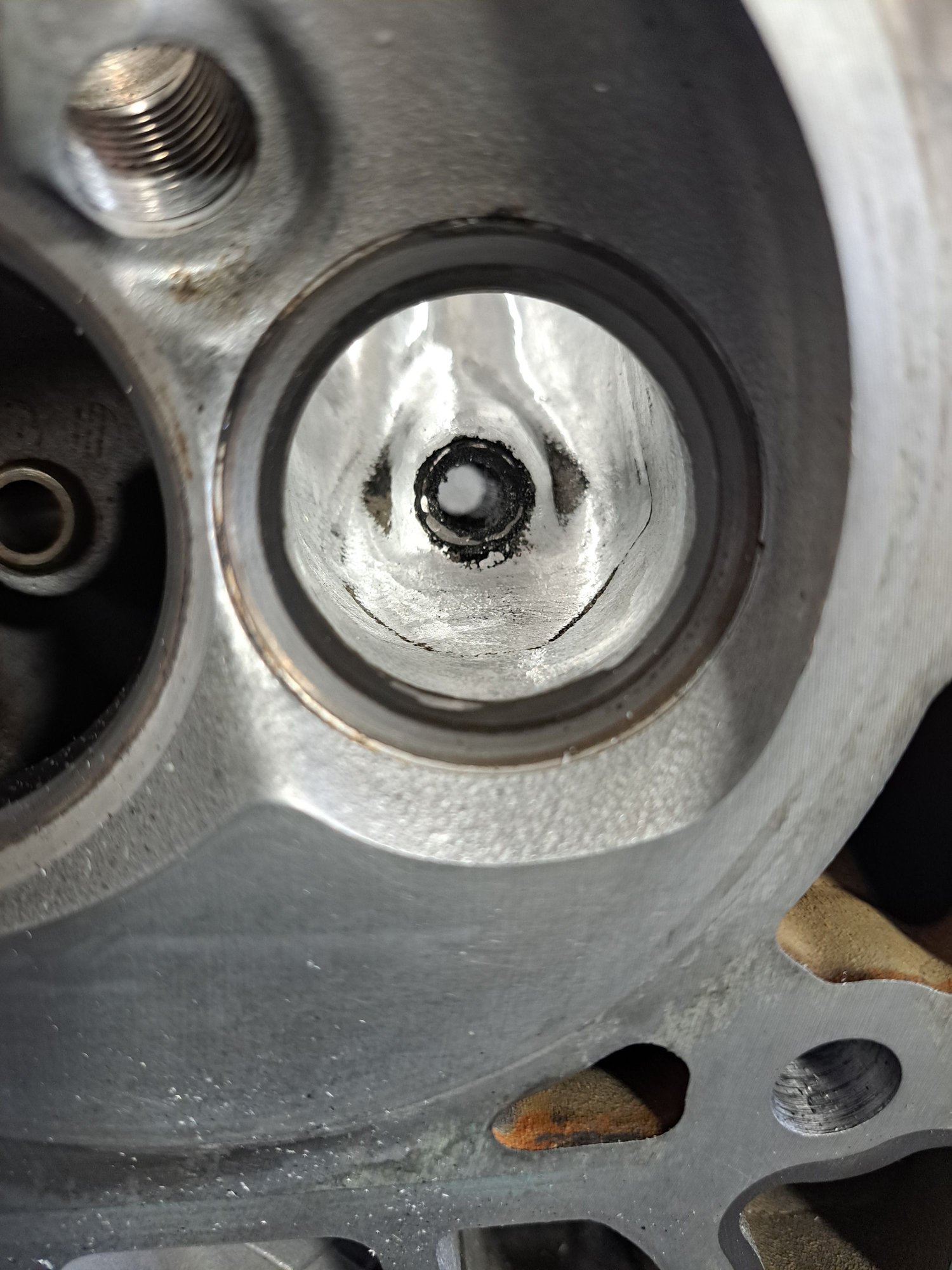

Picked up these 241s low mile for 115$. First time porting, advise appreciated.
is the split too point on the intake runner?
Going on an lq4 bored 4.020 dished -7cc to run 10.5:1 ish until I buy aftermarket.
Going to be running new ev8 stainless 2.000 and 1.55 valves.
Possibly installing new bronze guides.
Running .660 btr dual springs with titanium keepers and seats.
Btr high rpm trunion kit. Are there any rockers worth it that are lighter?

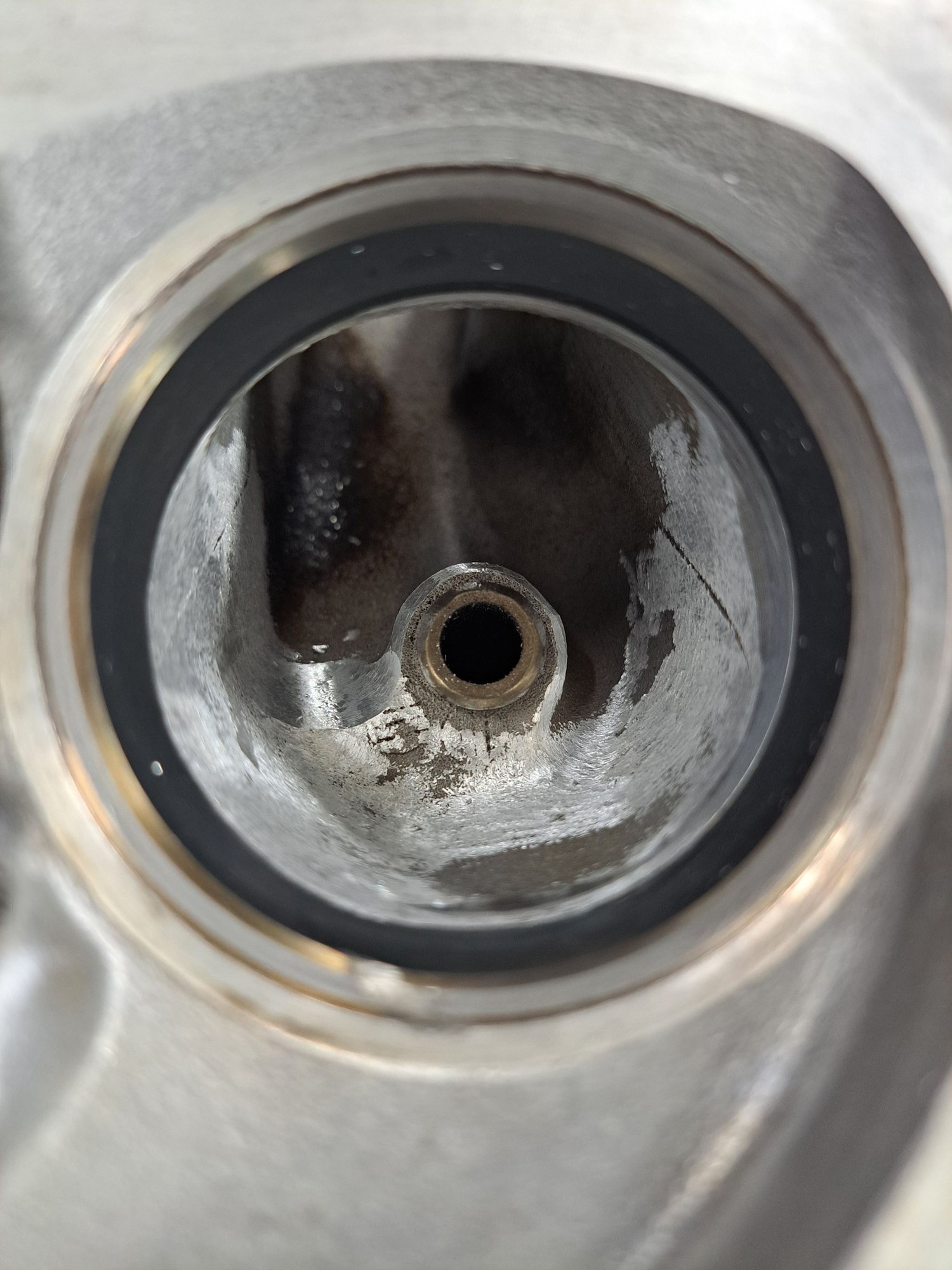

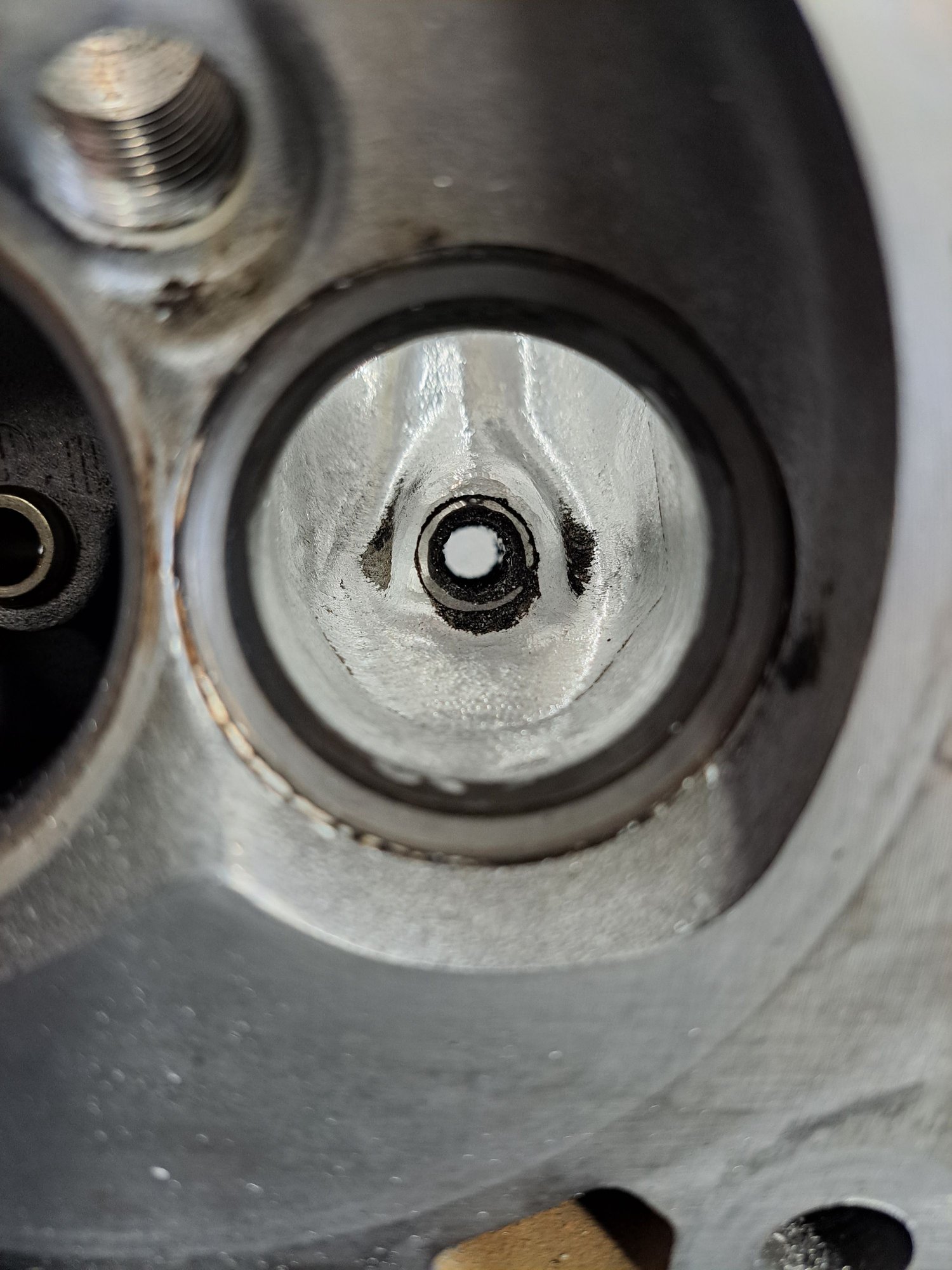

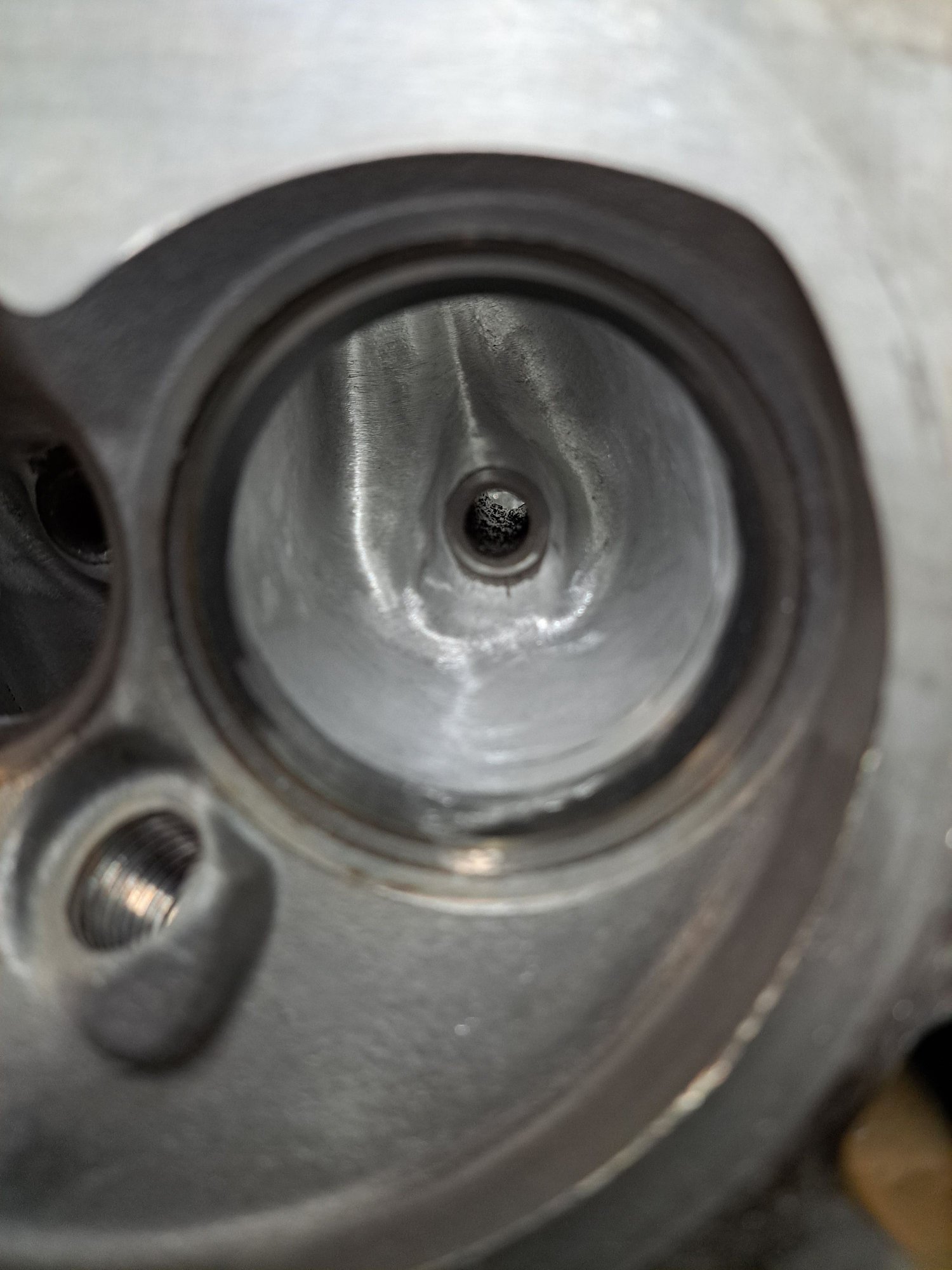

Pretty much finished with 1 head.

I wouldnt recommend bronze guides. They will not last unless you use a roller tip rocker.
