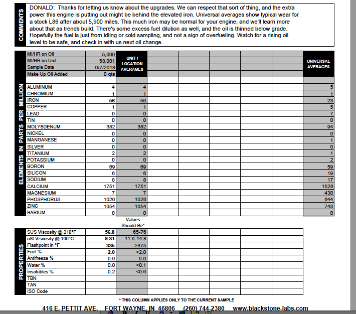

Old Jun 22, 2018 | 09:10 AM
the duke35's Avatar
Joined: Sep 2007
Posts: 34
From: Athens, Georgia
Default oil analysis back
Shop says there's metal in oil filter. Here's the oil analysis. Won't have the valve covers off and motor inspected for another 30 days....
https://www.performancetrucks.net/fo...1&d=1529676457
Attached Thumbnails 2015 GMC Sierra Whippled/Meth 6.2L opinion on repair-screen-shot-2018-06-22-10.06.19-am.png
