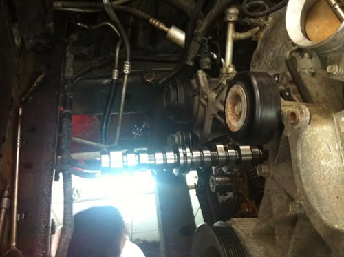

Originally Posted by K_ddsl
Thanks guys!
The Denali is now cammed!
Attachment 145275
I will get the data logging done today to send to Justin@BBP.
Hopefully shouldn't be too long before I have a solid tune.
what did you cam
