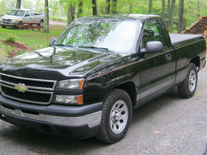

hello everyone. This is my first post on the site, but I have reading through everything for quite some time now. I have a 2006 rcsb silverado, 4.8 5 speed 2wd. I want to do a muffler swap, and I am going to go with a spintech muffler. My hang up is on the 2.75 inch exhaust tubing chevy uses. I am thinking of using a 3 inch in and out muffler and a reducer on each end, and keeping the stock tailpipe, or using a reducer in the front and going with 3 inch tubing exiting before the rear tire. What is everyones opinion of either option? Any opinions of spintechs on these trucks would be appreciated too. I have read nothing but good things on this site, but many people I talk to in person have no idea what they are. Thank you in advance for any help!
