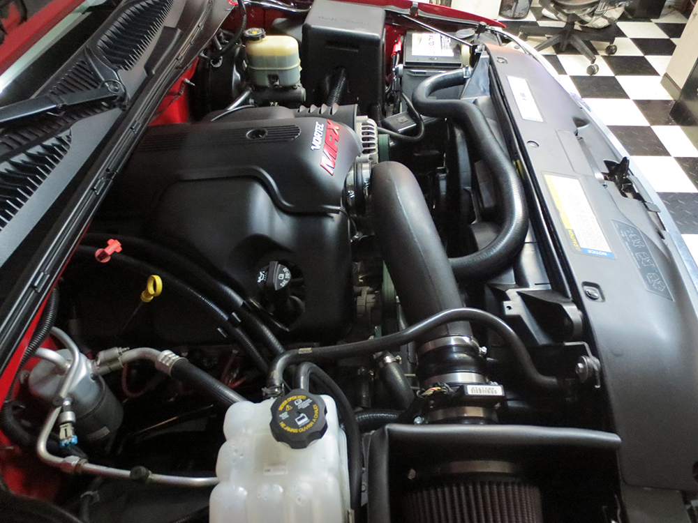

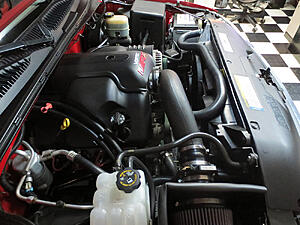

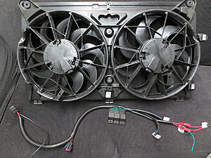

The HD fans from a GMT-900 (2007+) have an extra blade on each fan and fit the GMT-800 (99-06) trucks like a glove.

Saskatchewan has you pull it yards.. go find an 05 to 07 gmt800 half ton and take the e fan harness. Then take its fans. I live in Alberta and have had the same 5 and 7 blade fans from a V6 truck on my 05 HD for over 10 years and they keep it perfectly cool. We don't live in some tropical climate lol.
