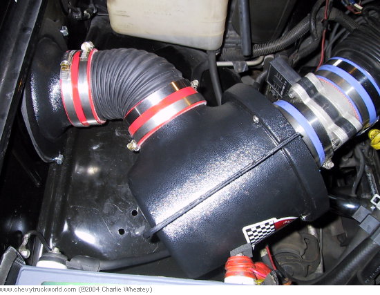

Looks like it sucks the air from the fenderwell...

There's gotta be a way they do it...from their description they are making it seem as if it isn't sucking underhood air....from their website:
This has been accomplished by producing a true sealed Cold air system that uses a multiple venturi design to maximize overall airflow efficiency, no leaky boxiest that suck under hood hot air, no chopping ,cutting or custom computer tuning!

Here are some pics of the system installed on my truck -
The system is pulling cool air from under the truck. It would be flipped over if you connect the ram air tube -
