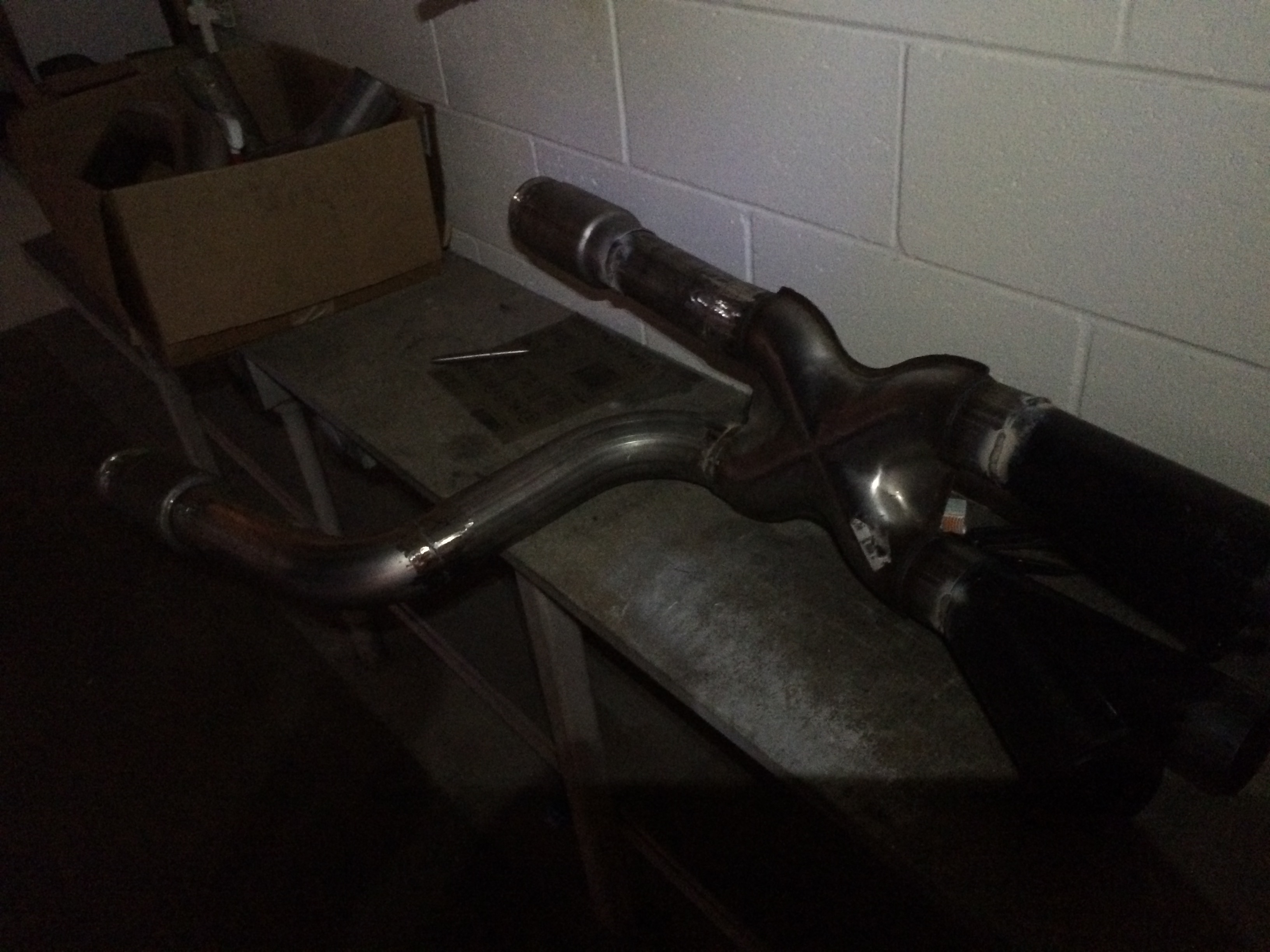

No is not done yet i only have pictures of the parts lol i just made some copper gaskets for my long tubes and some . flanges with copper gasket and i just receive my x pipe.last week waiting for the magnaflow to arrive and my stock cats i made it 3 in pipe original is 2.5 i think just for i can get some more.flow i need the cats to pass emission

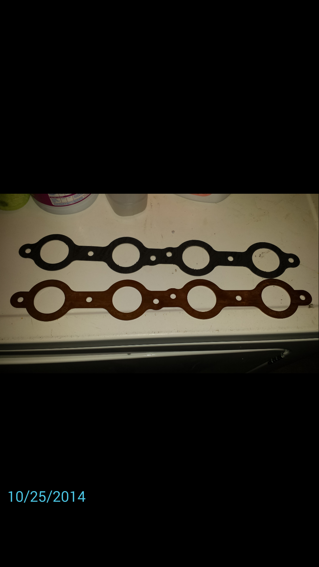

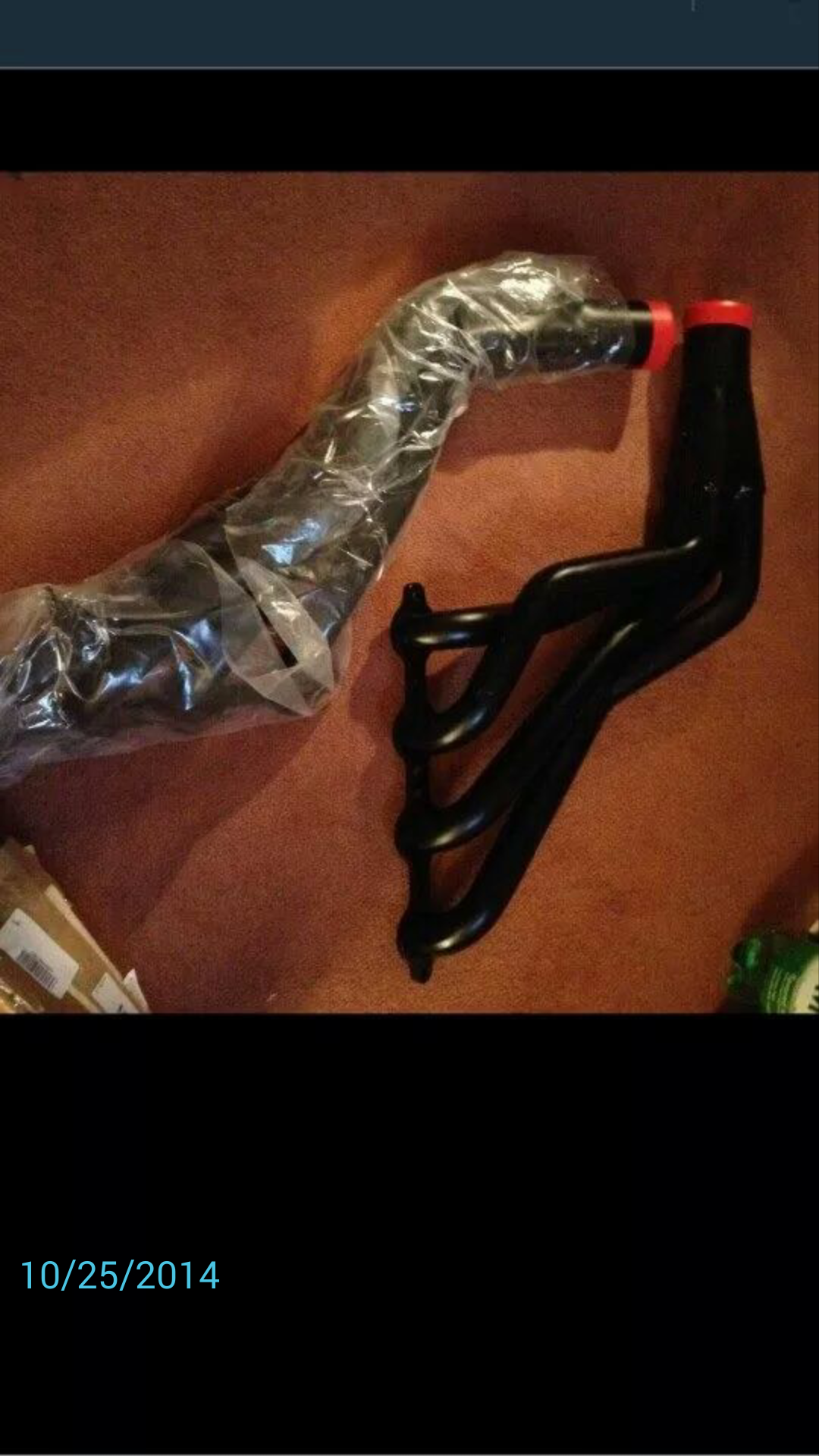

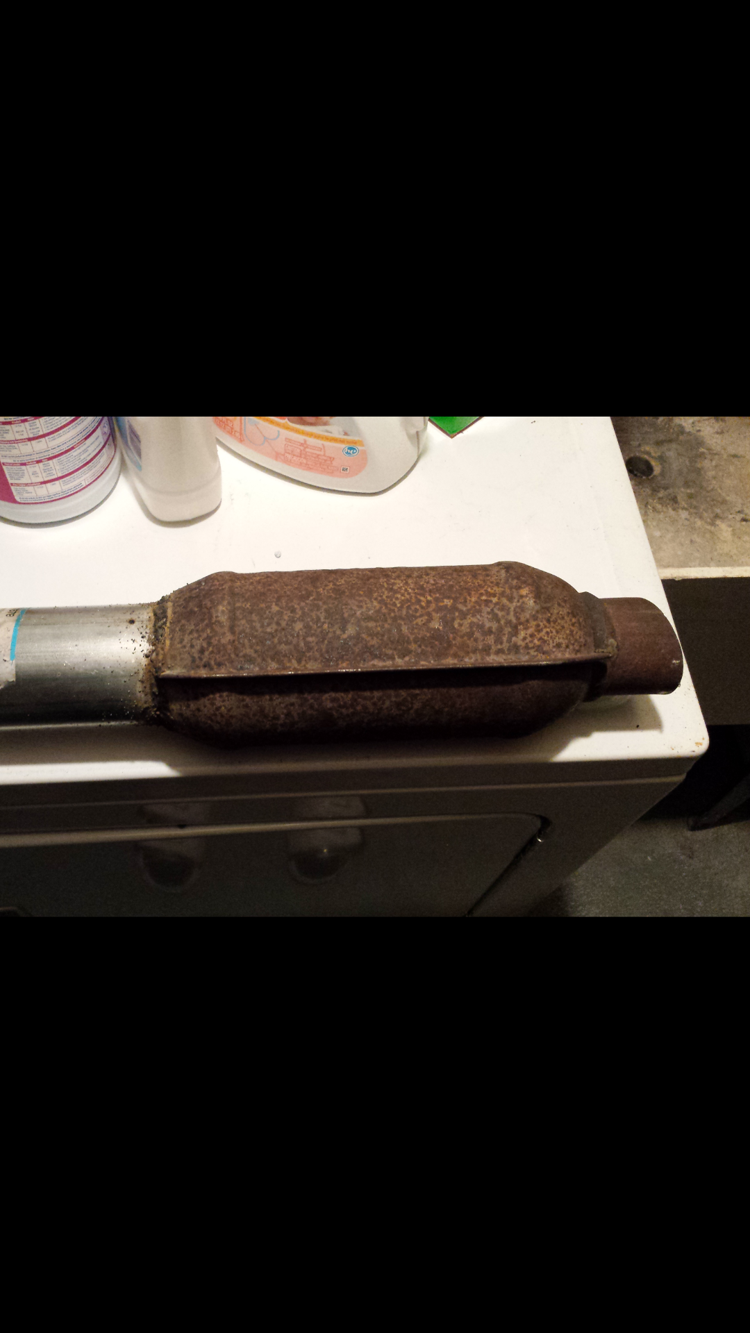

Here are some pictures or the long tubes copper gaskets i did my self and some flanges with copper gaskets and i re-weld a 3" pipe in my cats to replace the 2.25-2.5 stock pipe to allow more flowingj
