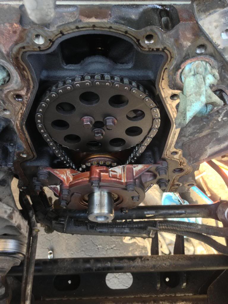

timing cover removed

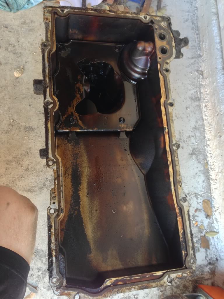

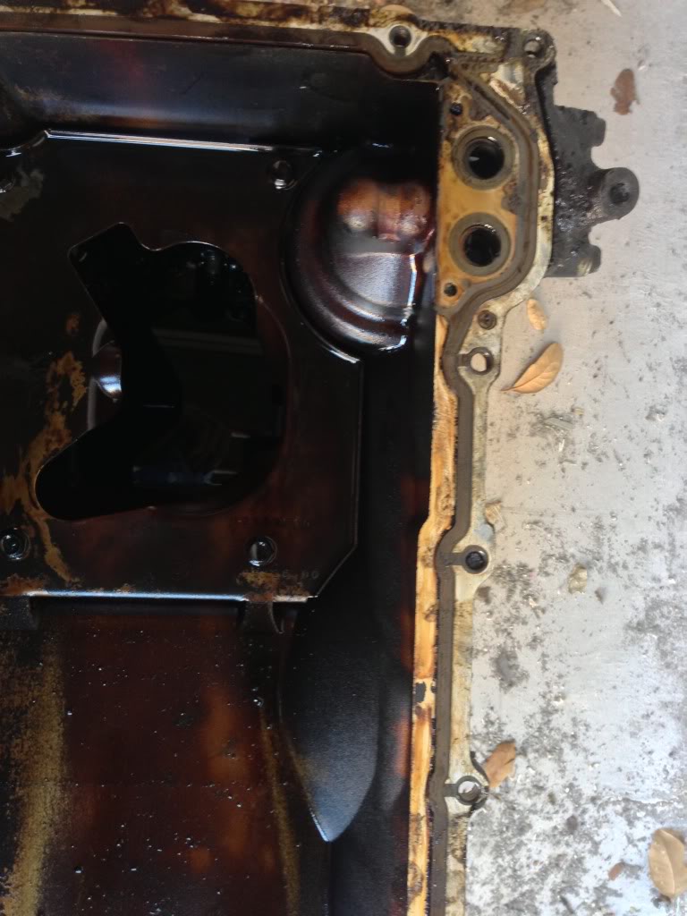

oil pan removed. pics

good news is there is no coolant in the oil! which i didn't really think there was. didn't get any pics of the screen on the oil pickup tube but it was perfect. no evidence of being clogged at all. also the green o-ring where the tube connects to the oil pump is in perfect shape as well. so it looks like the oil pump is going to be the culprit of my oil pressure problems (i hope! *cross fingers*)
also zero evidence of any oil sludge problems. although there is some strange residue on the bottom inside the oil pan, probably just due to a shitty gasket.
i know i have to drill out the rivets to replace the oil pan gasket, but should i rivet the new gasket into the oil pan as well? want to do this once, and do it right.
also is it bad to be leaving my truck outside without the oil pan and timing cover? there's only a 10% chance of rain in the next couple days and temps will be 60-90*. plan to have this back together by tuesday afternoon. should i cover it with a trash bag or something?

Why replace the gasket it should be fine. I put a bead of hi temp copper RTV around mine for extra insurance no issues.

i'm almost 90% sure its leaking. there's literally oil dripping off of almost every bolt at the back of the engine. no idea where its leaking from. but i want to just replace every gasket regardless. i know the rear main seal probably leaks too, but thats going to have to wait. do not feel like dropping the trans right now.

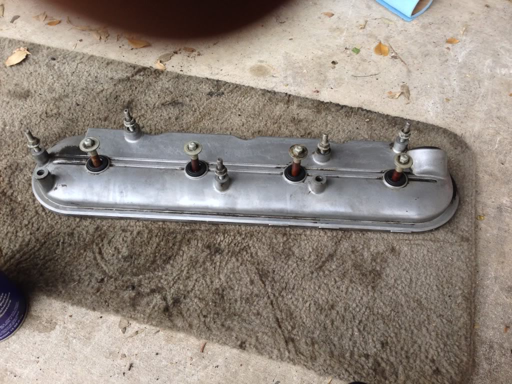

driver side valve cover as clean as its going to get

thought about painting them, but i just want to get it all back together and running. i can always go back later and paint them

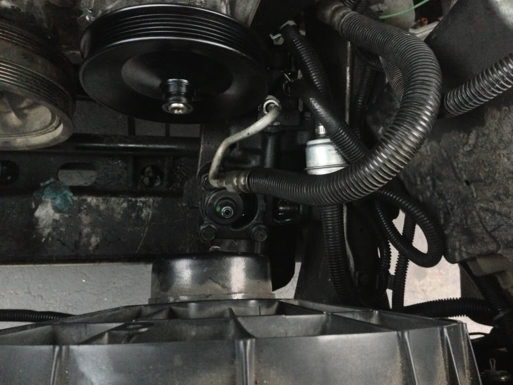

aftermarket power steering filter

Nice work, good thing you replaced oil pan gasket -- rubber on the old one looks compressed.

yeah at 200k miles i'd be surprised if it wasn't!
