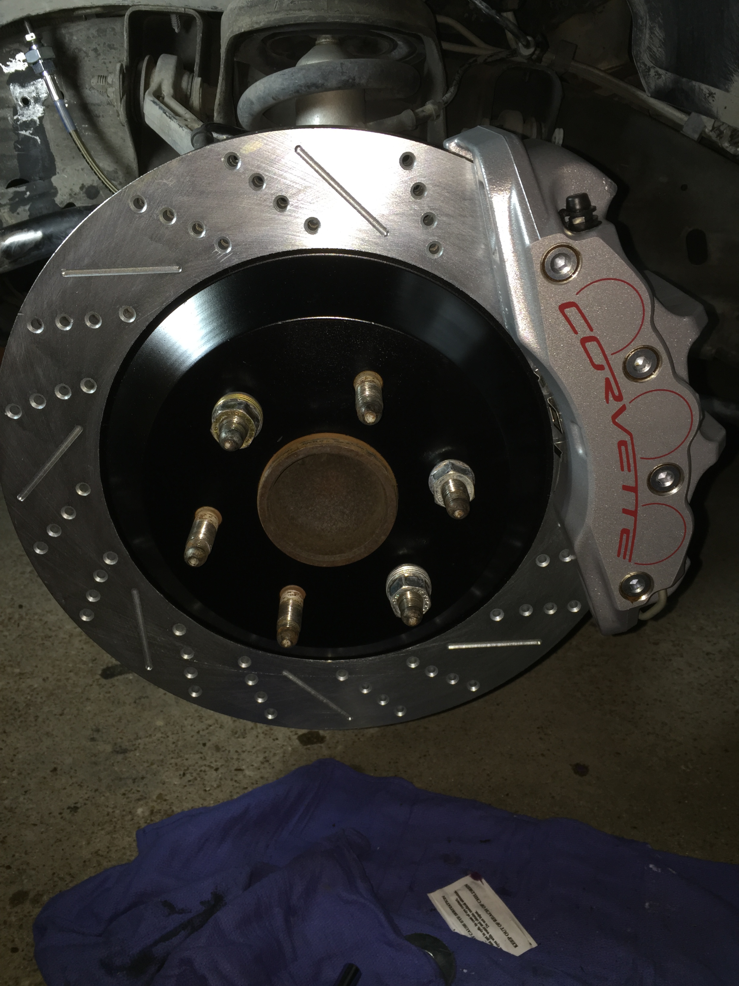

Install is done and these brakes are fantastic!

Old Jan 19, 2015 | 01:37 AM
02_Orange_D1SC's Avatar
Fastest D1 Procharged Truck
iTrader: (30)
Joined: Mar 2007
Posts: 3,132
From: mASSHOLE
i had these brakes on my truck few years back loved them but hated i could only run 20s so i ended up selling them
Old Jan 24, 2015 | 09:13 PM
Todd Worley's Avatar
Joined: Sep 2014
Posts: 24
They are a huge leap over the spongy stock brakes.
