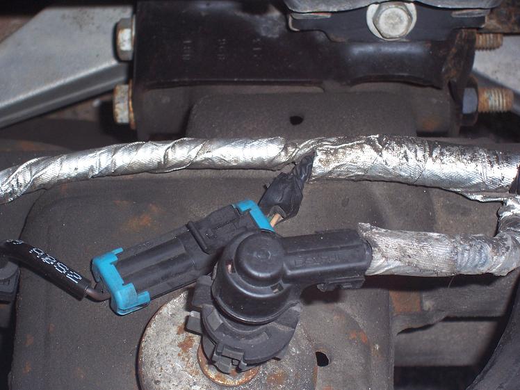

I picked up a 2500 suburban over the weekend
Anyway it sorta feels like it could used some new shocks. The windosticker says it has the option auto ride and tow package...
When i popped the hood i saw this on the front two shocks. What the heck is that and what does it do?
Attached Thumbnails WTF?  Shock sensor?-100_1761small.jpg   WTF?  Shock sensor?-100_1762small.jpg

IIRC the autoride feature is either an adjustable air shock or a magnetic fluid shock, something like that. That line you see there is either a power line for the magnetic shock or an air line. That's my best guess anyway.

I believe it's an adjustable damping rate for the shocks...not just a load helper like the rear bags would be.

To the best of my knowledge, the sensors feed data to the Stabilitrak system, but there is no adjustable damping or magnetic ride control in the shocks. You can replace the shocks, but you'll need to run some inline resistors to eliminate the "Service Ride Control" nastygram on the DIC. I did this on my '03 SUV after dropping the suspension...I ran Bilstein's designed for 2WD rigs. I can look up the specs on the resistors and get back to you, but...honestly....I think what you're experiencing is the 2500 ride quality. Obviously I can't speak to the history of your rig, but in general I'd be really surprised if new shocks had any effect.
