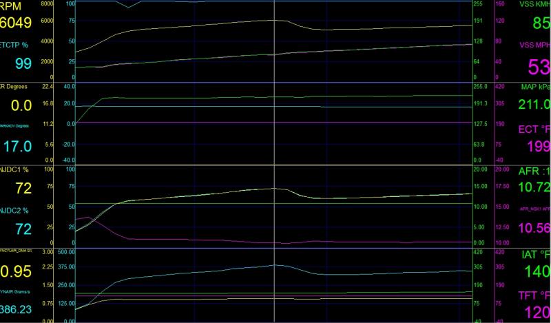

Here is the shift when commanded was 5800. Actually shifts at 6000 and throttle stays at 99%.

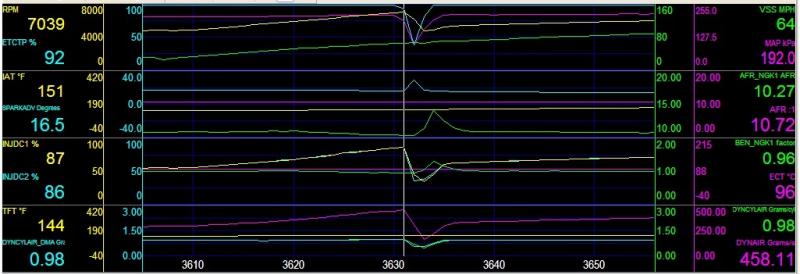

Here is the shift when commanded at 6500. You can see that it runs to 7000, then the throttles close and re-open over a period of .35 sec. This was during my 10.99 ET run. I was wondering why people were saying it sounded like I was letting up on the throttle.

I did have to lower mine a little bit as I made more power. Can you log the gear to see if it is commanding a shift? That should tell you if it is a PCM issue or a tranny issue.
