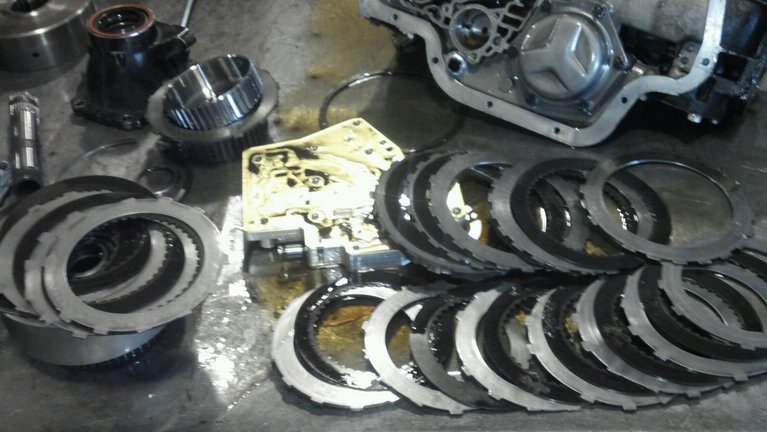

Here's a set of clutches out of a Th400 used in a bottom 8 second car using Hy-Gard that had 2 years of run time on the street and strip with hundreds of passes. We freshened the trans, made some changes to the valve body, lightened up some parts, and it's now running 7's.

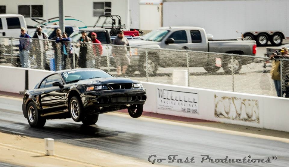

Here's the car.
