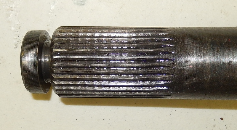

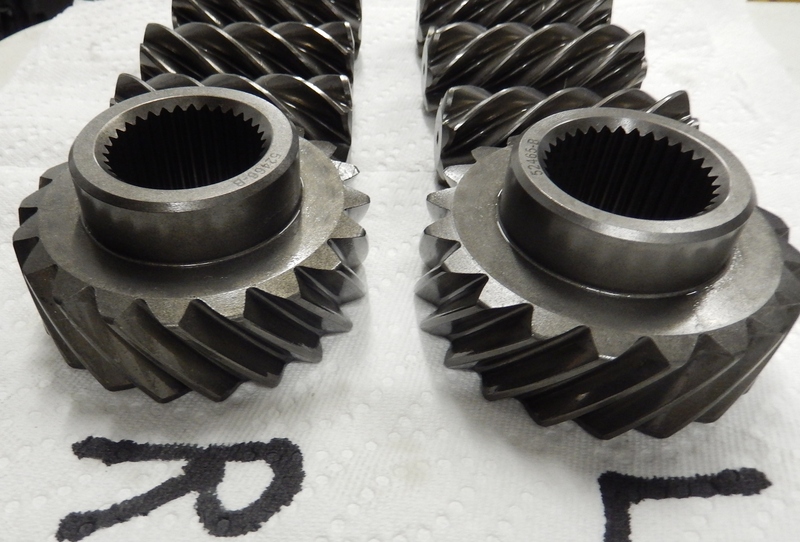

I was thinking that the one axle was spinning freely and the other was not turning because it was so hard to turn that one. Both sides are connected via the helical gears so I though something could be broken. Took it apart to inspect and didn't find any broken parts. The helical gears on the left side do feel a little rough though and there appears to be some twist in the splines of the left side axle. It may have already looked like that the last time I took it apart.

Right side helicals
One of the left side helicals
Side gears and helicals both sides
Left axle (Yukon Gear)

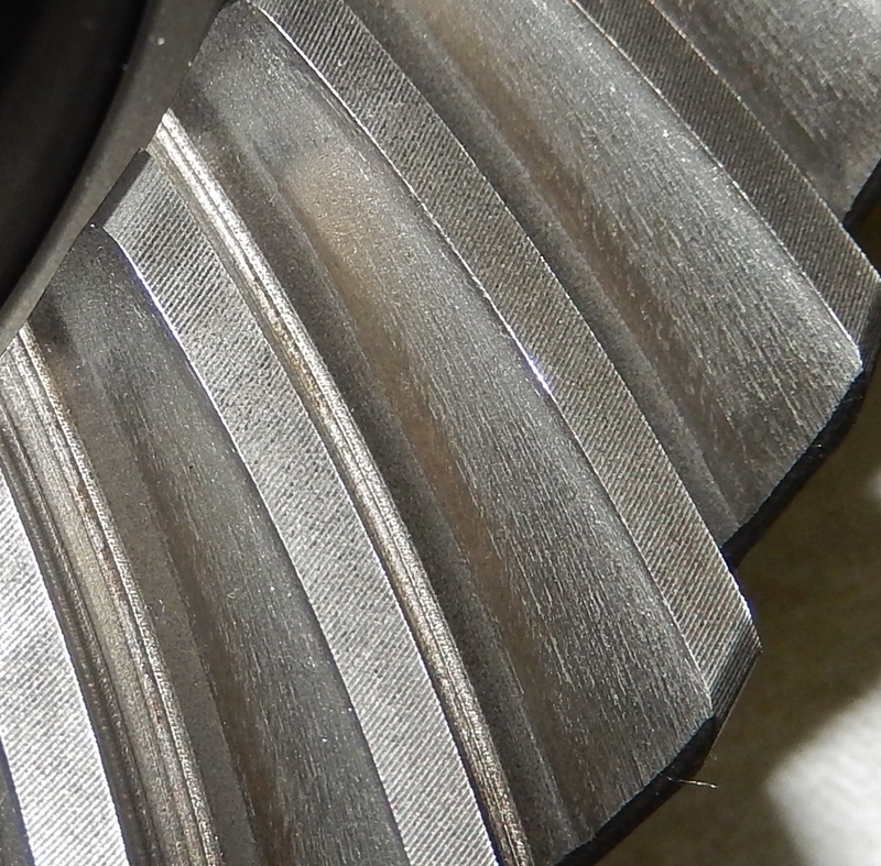

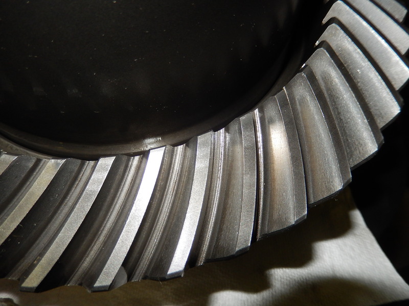

Ring gear

In looking at your ring gear, besides that it's destroyed, the contact pattern seems too far to the heel.
The axle's on it's way out, I would not put that back in.
You're getting good traction apparently. You might consider making your next gear set a numerically lesser ratio - that will reduce the torque all these components see.

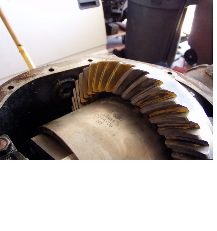

I think the pattern looks very similar to the initial setup. Found this old pic from 9.5 build threads.
https://www.performancetrucks.net/fo...lanche-421388/
http://chevyavalanchefanclub.com/caf...,101041.0.html
