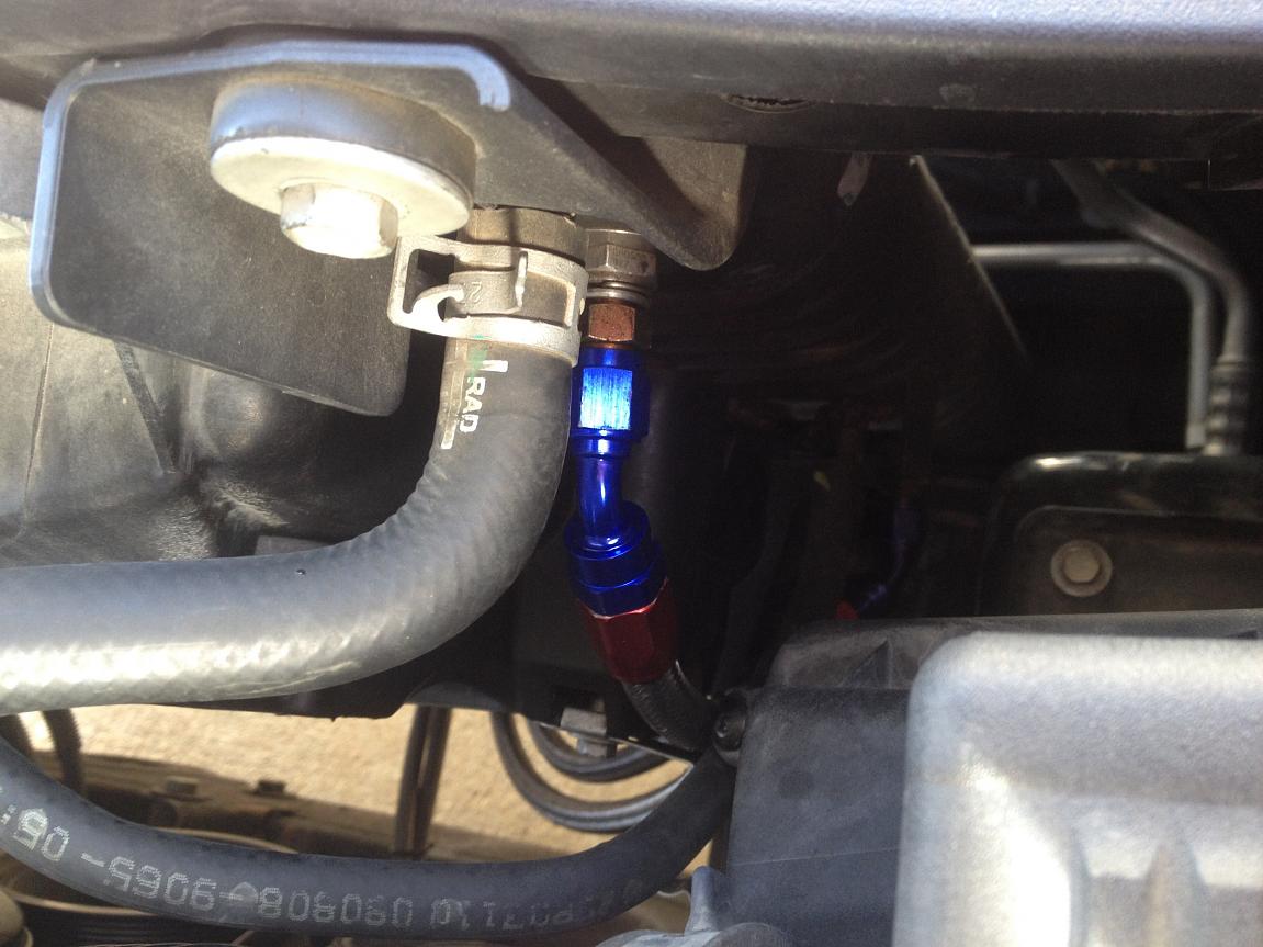

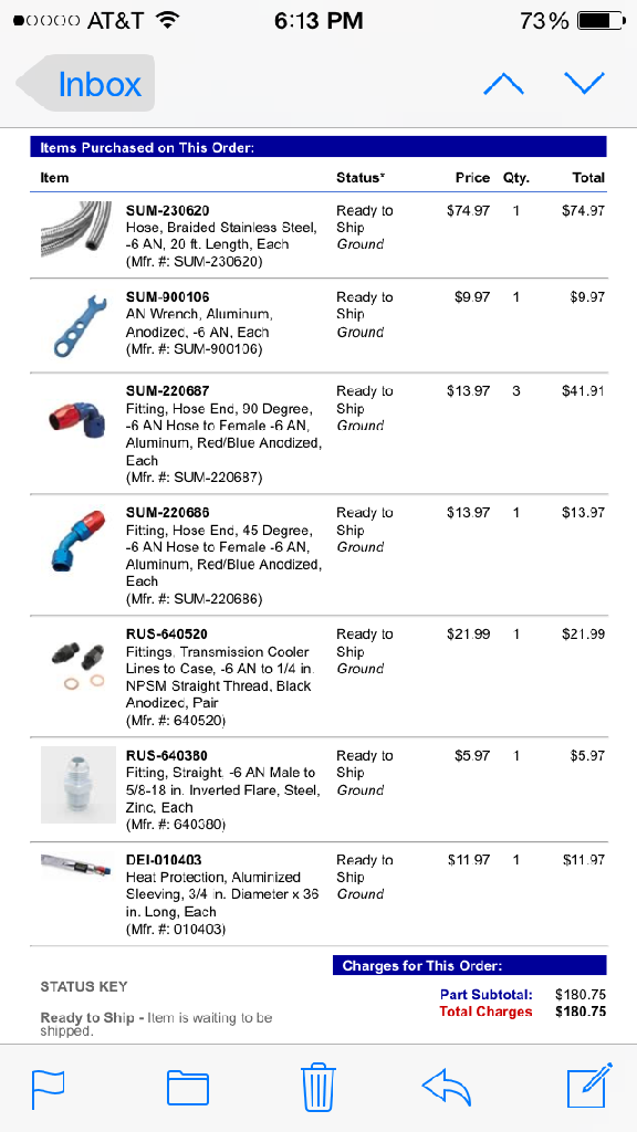

You'll need (2) 12055 from pure performance for the radiator connections.
https://www.performancetrucks.net/fo...ttings-519740/
I'll try and get an installed picture tonight.
you don't have to use the radiator. most by-pass the radiator with a tru cool and keep the temps about 140
I like the idea I keeping the radiator in the loop if it wasn't my trans fluid would have a hard time staying at operating temp in the winter. On 100' days I only run 30' above ambient.
