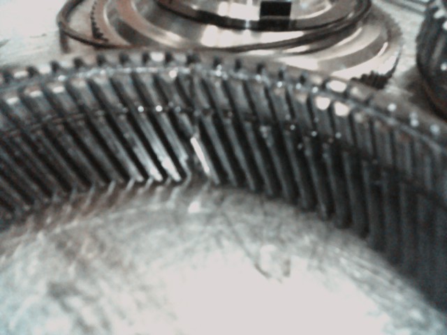

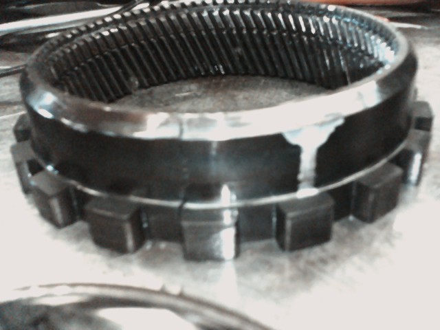

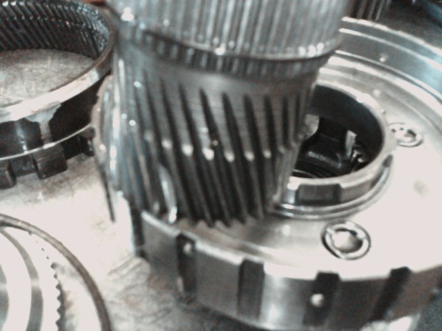

He did tell me that the only thing that was broken was the parking gear, all of the stuff that normally breaks was fine, and that even though I have beat on the tranny a little bit he said it was in great shape. The thing that f**ked me over was the metal shavings that went everywhere internally. I guess they damaged a bunch of stuff. He said there was a little bit of glazing on the clutches, but none were burnt. Told me again that the only way he can think of this type of damage happening was that I was bumped in a parking lot while the truck was parked. It looks like if whatever happened didn't happen that the tranny would have kept living for quite awhile.

Here are some pics I took of the parking gear (split right up the side) and the sun gear from the rear planetary set (lost one tooth). I think the metal shavings are from the gear that sits inside the parking gear grinding once the parking gear split. I apologize for the poor quality, came from my camera phone.
I verified that all of the parts are OEM, and I think hardened parts are factory? Maybe the ones from the 4L70E? Does that sound right?
