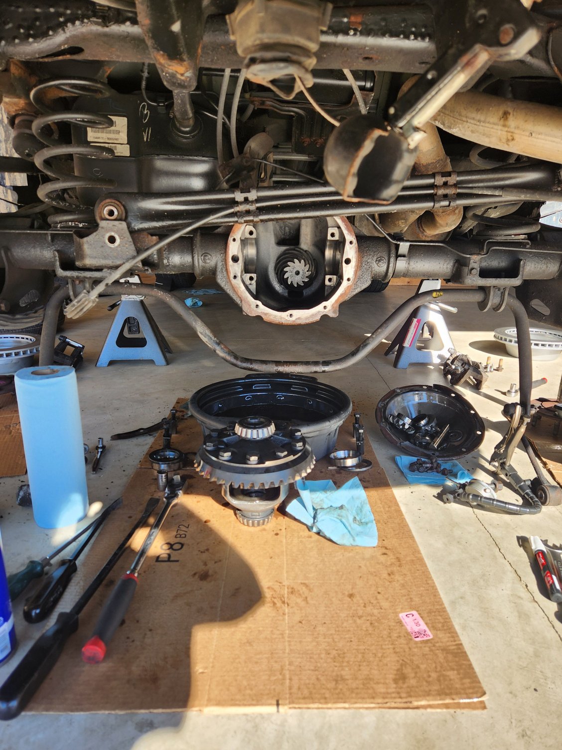

Well, got the truetrac in the escalade, now i just need to test it really good.

Looks like you caught it just before it completely self destructed...
surprisingly it wasn't making any noise and was greeted with that on teardown. I have torn down diffs that made a TON of noise and bearing looked better than that one.
