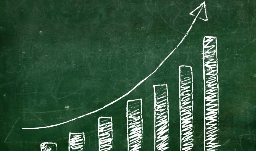

His truck makes boost very late in the rev range and something seems to be stopping it from revving as far as it should with that cam IMO. Its almost as though there is a restriction on the top end that makes boost spike... but as we all know boost is purely a measure of restriction. I know centrifigul blower make more boost on the top end, but most I see build at a flat rate, his builds like this as opposed to a steady increase:
Should just get rid of the boost so there will be less restriction.
