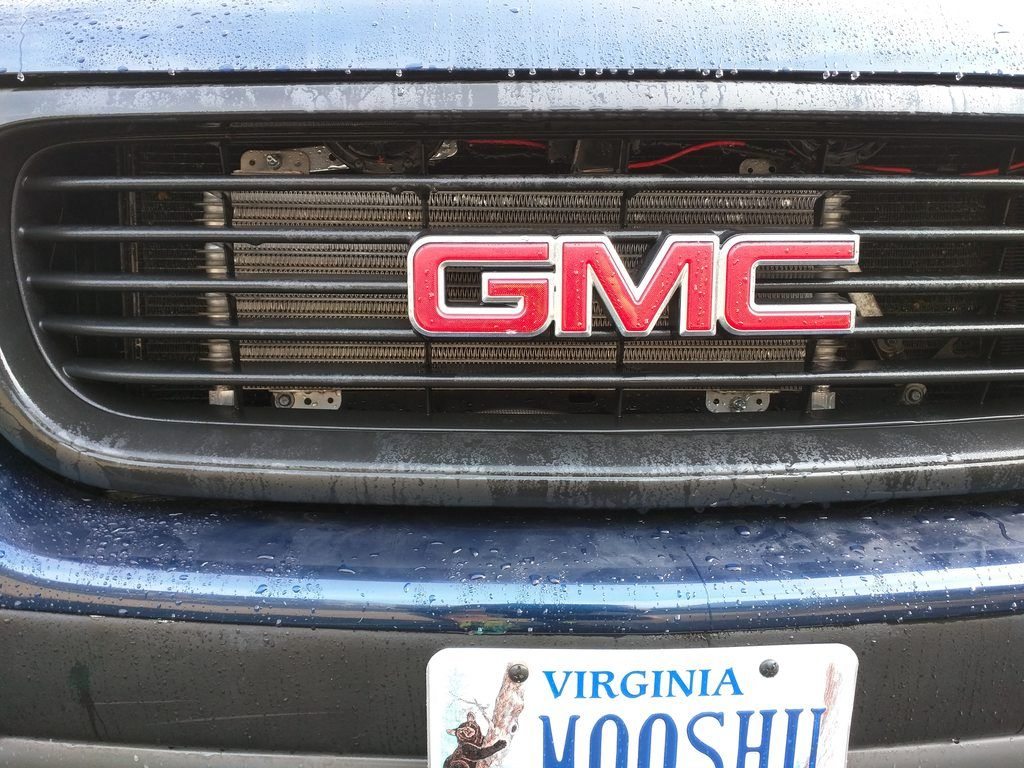

Mine are down. Testes in 2 hours of highway speed at over 100F ambient. Trans temps never went over 130F. No special bleeding.

The cooler I have in my Express is mounted nipples down, same design as the true cool. Plumbed in-line after the factory in-radiator cooler it runs about 150°F at its hottest and that is pulling a 6K travel trailer behind a 6,200 lb Express.
