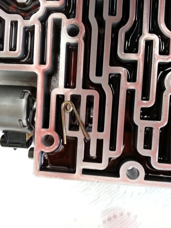

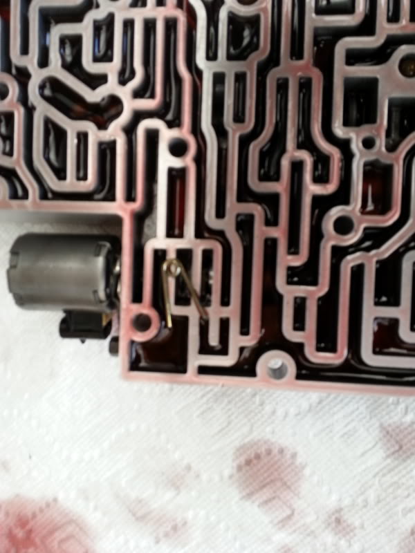

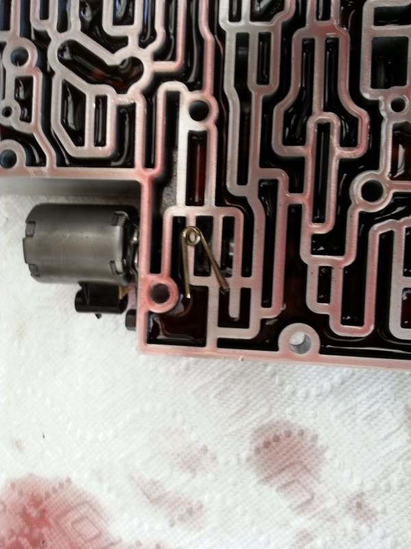

I took dropped my valve body and there was this spring lookibg thing sitting on top of it. Like it fell off from somewhere. Anyone have any idea where it goes??
Old Oct 11, 2013 | 01:14 PM
cwalker2006's Avatar
Posts: 1,183
From: dumas, texas
Posts: 1,183
From: dumas, texas

Parking pawl, maybe?
Old Oct 11, 2013 | 02:16 PM
Posts: 1,183
From: dumas, texas
Its from the opposite side. The passenger side. It was laying on there when I dropped the valvle body. I didn't hear anything fall at all.
