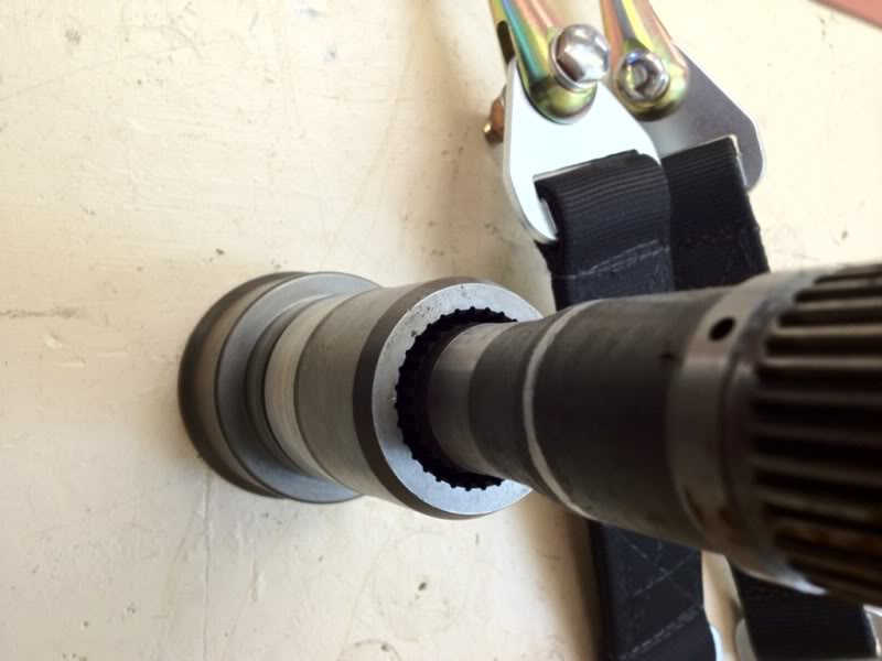

For reference for those who haven't seen the size difference.
This is a stock 65e output shaft sitting in a NVG149 input coupler that's been machined for the larger 80e output shaft.
