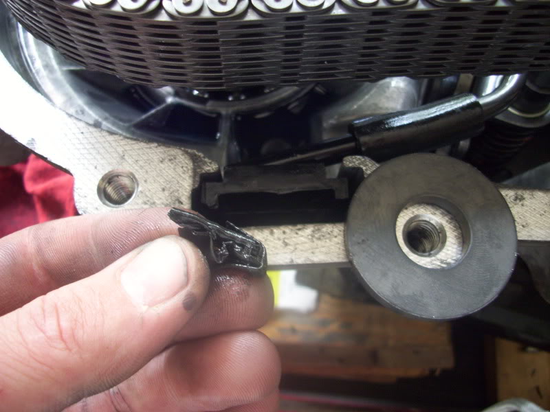

I went to the dealership and said "give me the stuff you use to seal the AutoTrak transfercase with, and this is what they gave me:
GM Gasket Maker PN 1052943...the **** was really expensive though, over 20 bux IIRC
Here's a pic of the revised Tcase pump clip:
Some of the sealer that I found clogging my tcase pump pickup:
More pics and info here:
https://www.performancetrucks.net/fo...+Level7&page=3
Do you trust that that little clip will actually stop the pump from cutting the case?
